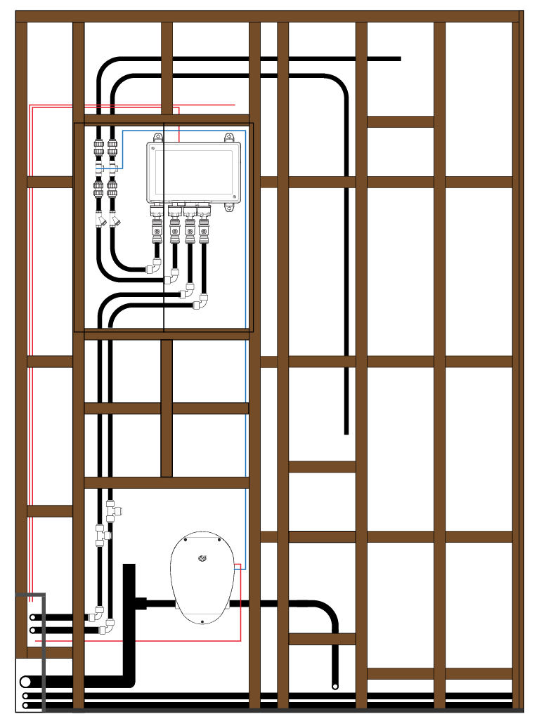

Can someone take a look at the below and let me know if you see any issues with what I'm planning on doing?
The image is the stud work I am adding to the back wall of the bathroom.
The shower mixer (top left) is going to be exposed (for access) and sat behind a mirror with lighting in it. The red lines are the power to both.
The waste pump (bottom left) will be exposed (for access) and sat behind a vanity unit sink. The pipework next to it is the hot and cold feed from the thermal store and the waste pipe from the sink, the T's will be attached to flexible tap connectors and the waste to the sink trap. The pump is Zone 1 rated.
Are the positions of these items in relation to the water supplies acceptable? The sink sits over 60cm away from the pump above and all of the wiring will be fed through the stud into areas closed off with aqua panel and tanking.
All of the wiring will of course terminate out of the bathroom (in an airing cupboard next door).
Thanks for any help in advance.
