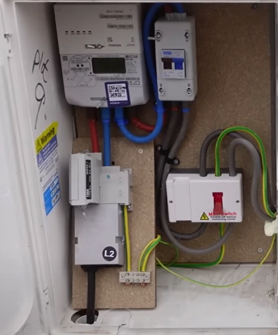

whilst watching many a video in the middle of reading the many books on the journey to becoming a qualified sparky, i notice in a setup, that seems to have multiple main switches and fuses before the distribution board, as i am far from being qualified, let alone experienced, i was wondering if anyone could shed some light on the set-up, more so on the switch/fuse to the bottom right of the picture, as it seems extra, but i have no idea as to why.

Very simple. The maximum length allowed for the meter tails connection to the consumer unit is 3 metres.
If it is more than that a fuse must be provided to provide over-current protection.
You can’t have 10metre tails only protected by the supplier’s fuse that is in the service head.

ah, makes sense now, this is only the second time ive seen this set-up, first one being in my mother's bungalow - a 60's build completely re-wired including a new incoming cable all the way back to the overhead line/pole,

another thing about long tails is if they go through the fabric of the building then they need RCDing as well unless you can get them more than 50mm deep everywhere, so unless you want to start messing about with time delayed RCD's and all that its easier to use a steel wire armour submain instead of tails.
I can kind of see his point though, the cutout has a 100A fuse and the KMF might do as well so technically any one of them might blow first in an overload or short circuit scenario. I don't really see what value it adds apart from obedience with the rules.
A properly designed installation would have a lower- rated fuse in the KMF than that in the service head. Otherwise there will be no discrimination.
