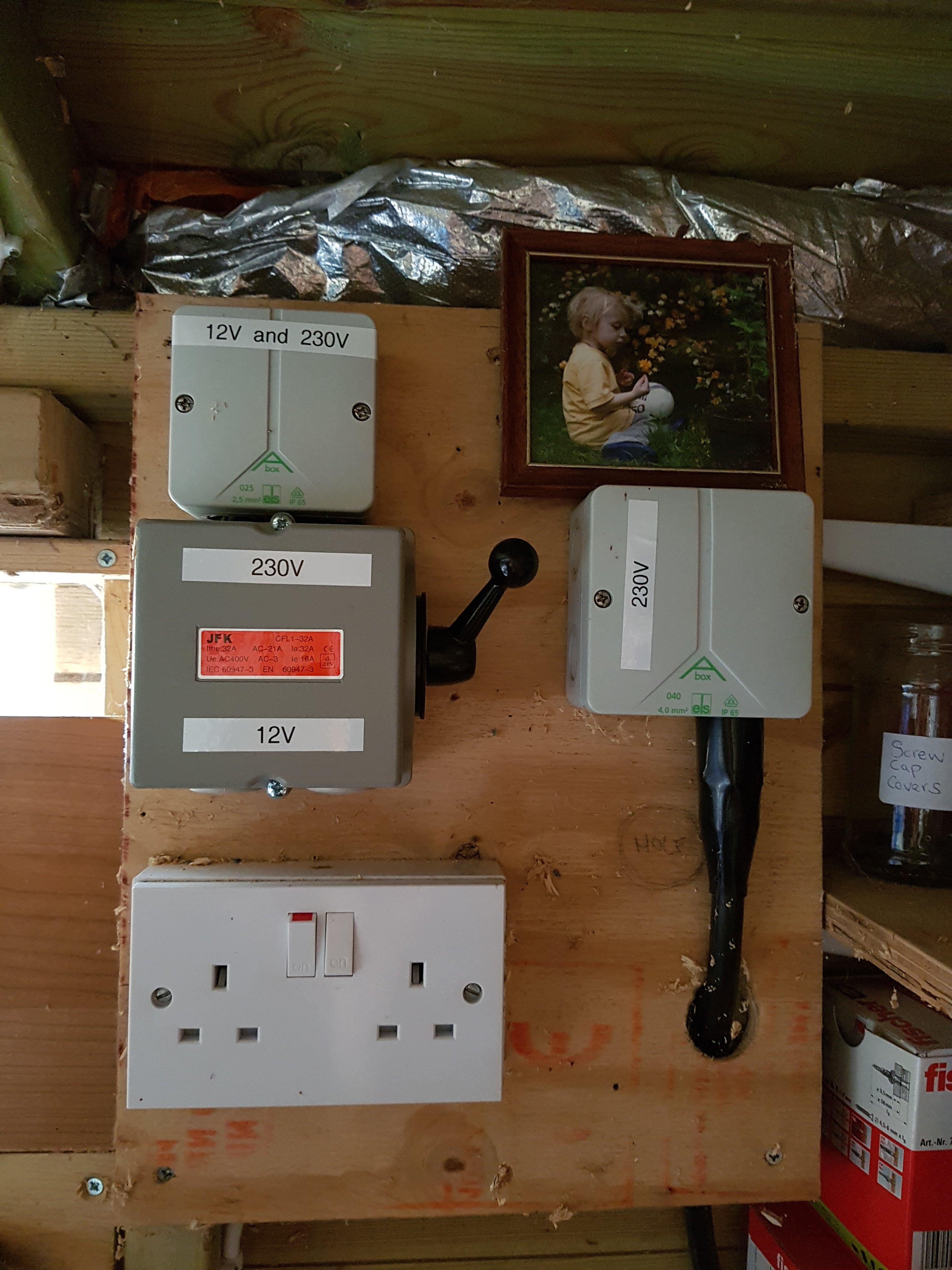

Actually, I've decided that you're right. No change over switch, no DC power supply, just a standard, cheap switch start batten that I've got left over from a job! :)
I have however just put a changeover switch in for my sockets... very exciting for a purely Domestic installer to mess around with something different. Bear in mind this is 'my' shed not a customers, hence not as neat!
