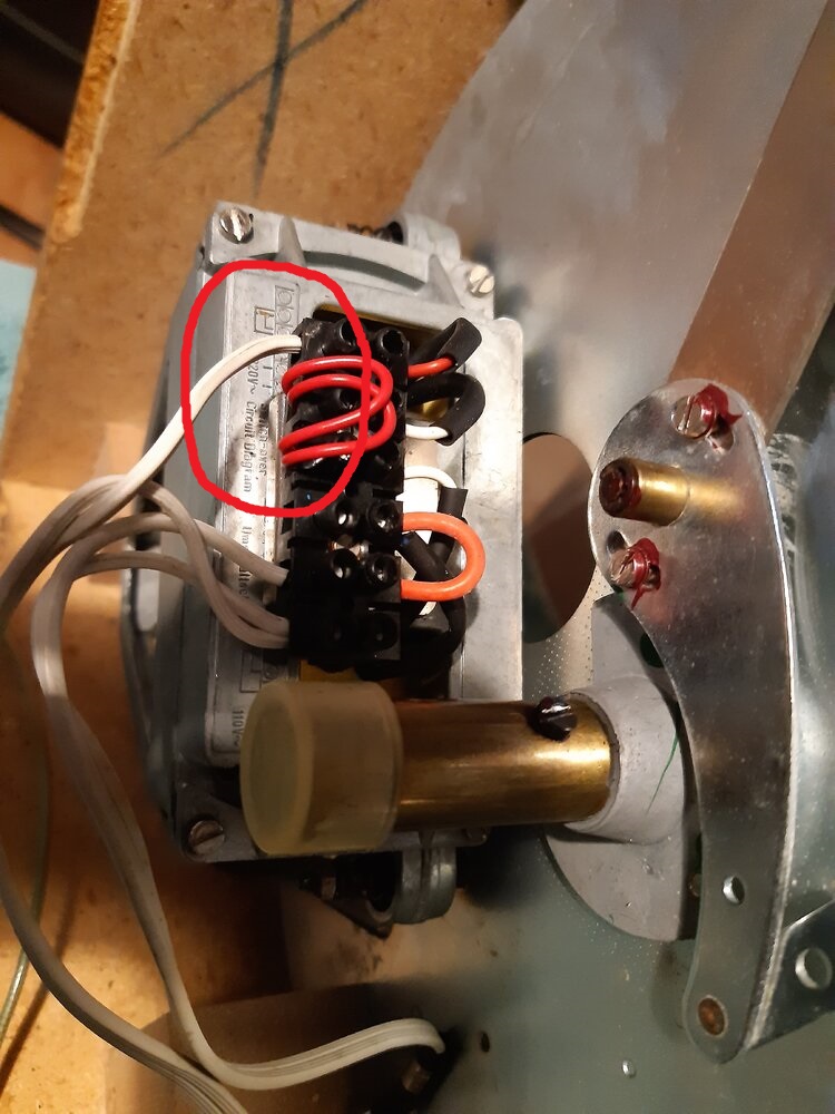

Hi, newbie here looking for some help. I've recently picked up a late 60s record player and it came without a plug.
I'm based in the UK and the power cables are not coloured so unsure which is live and neutral!

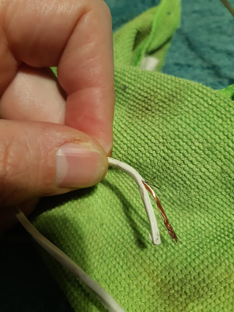

One cable has a thin black and white striped thread within the sheathing, obviously identifying something, but I dont know which! Being an electrical novice I dont want to wire the plug incorrectly.... anybody come across this before and can help?
Is there a label on the player that says what voltage it runs at?
Also, are you certain that the wire pictured is a power cable, not a speaker cable?
That looks more like bellwire than a supply cable, can you post a picture up of the player and any manufacturers plate etc?
And if that is the original cable I would be looking at replacing it as a matter of course, at 60 years old the insulation might well be starting to breakdown.
Thanks both. It's a Lenco LG75 running at 220v, with cables running into power supply RCA cables are separate.
Agree that its definitely due a rewire, which is something I'm planning as part of the restoration, but keen to power on and check everything is running before progressing any further!
As that's dual voltage I suspect its an American make? Looks like the live needs to go to the second port from the right that connects to the large red jumper cable.

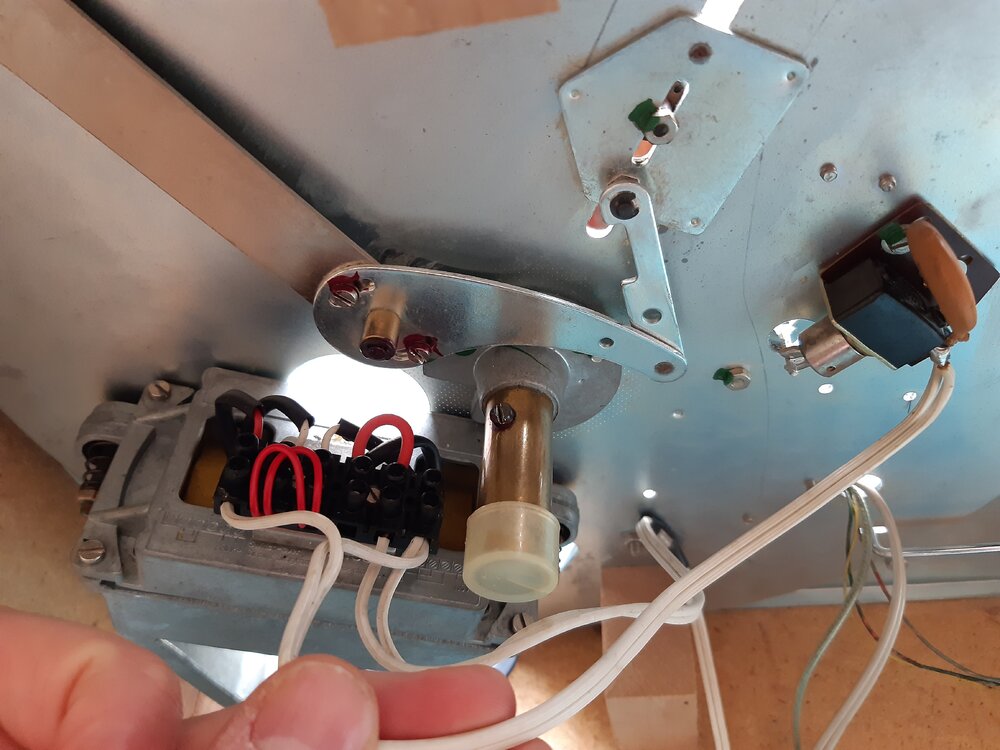

The mains input wiring you show is not original, as commercial examples would have followed the red/black convention of the day and had a separate outer PVC sheath. I suspect the cable you show in your photo is really for loudspeaker use, as many such cables are figure of eight in cross section with a thin black stripe on one of the PVC insulators simply used to ensure that they can be wired like with like (+ to + and - to -) for stereo pairs.
You will certainly need to rewire using 3-core flex, with the green-yellow cable connected to the metal chassis of the turntable to ensure that a proper earth path is provided. When you connect the two signal cables from the arm to an amplifier you will be providing a path to earth through the screen of the signal cable via the amplifier, so the last thing you want is to get a shock while attaching the cables to the amplifier or for the turntable to go bang and trip your mains mcb or fuse through poor wiring.

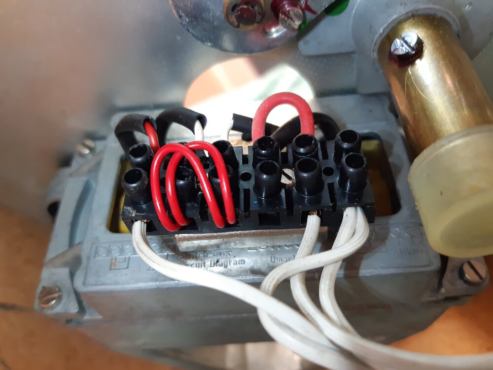

Just to confirm, as suggested just to double check, Live would be the 2nd from right where the red jumper cable is
Can't be certain, but it seems to be the most likely. It follows the red-black convention, with the right-most being the neutral in black (I assume).
I guess the other figure of eight connection shown (connected to the leftmost terminal and the assumed neutral on the right) goes to an on-off switch somewhere?
I think that reverses how you should treat the live and neutral. The switch cable is connected in common with the incoming power cable on the right side, so this has to be the live feed as otherwise the switch would be breaking the neutral, which wouldn't make sense and would leave the motor circuit connected live with no neutral when you switch off - clearly dangerous. Can only suggest you try wiring live to the right given the way the switch is wired, and bear in mind the dangers of getting it wrong.
Whoever wired the connections may have moved some of the jumpers to get it all going, so the red/black convention may well have been thrown out the window...

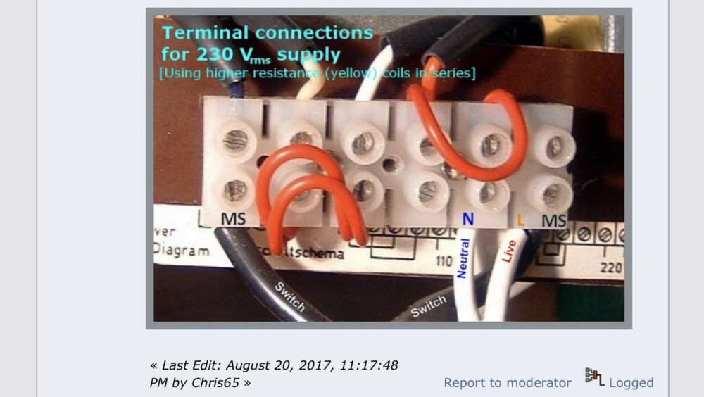

Found a post in a specialist forum. Reading the post linked, the right-most IS the live. See The Lenco Motor - Lenco Glossary - Lenco Heaven Turntable Forum - https://www.lencoheaven.net/forum/index.php?topic=68.0

As an aside, having dealt with vintage record players a lot in my time, that mains flex may well be original. They didn't always use the standard red/black/green - see here for a brief bit on fig8 cable. It was often found on very low current appliances such as electric clocks and turntables. It was a bad idea all around as the insulation can get damaged just by looking at it.

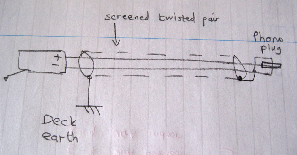

One thing to watch is earth loops. Turntables are very susceptible to this because of the very low (circa 3mV from a moving magnet cartridge) levels involved.
Often if you earth the deck you will get a hum loop because of the earth to the amplifier. If this happens you may have to remove the deck earth and connect a separate earth lead to the amplifier. All decent amplifiers that have a phono input have an earth terminal specifically for this purpose.
The other way to reduce "hum loops" is to use screened twisted pair cable so the screen is earthed at both the deck and the phono plug, but the "ground" pin of the cartridge is connected via one of the twisted pair and earthed only at the phono end.

The basic idea:
For stereo you need 2 twisted pairs of course!
