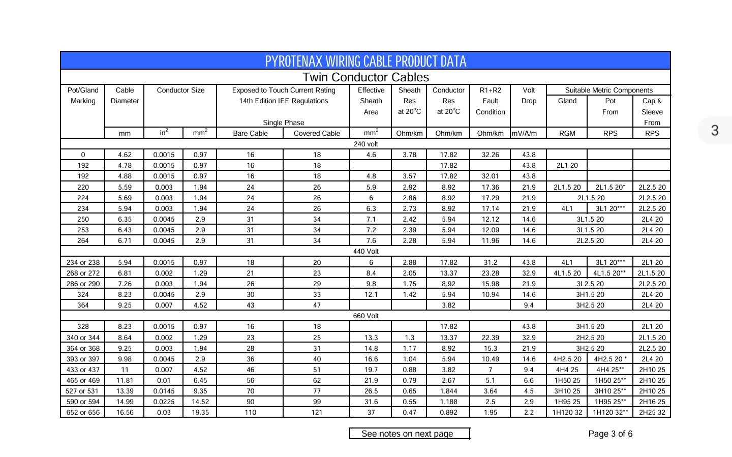

The rating of a 2.5mm² MI cable is 31A (light duty) or 34A (heavy duty) so in either case you can argue it is undersized. You can argue that it is a fixed load being purely resistive and it should not overload.

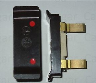

Apologies westward yes, 30A rewireable (the red one like the attached).
So are you saying that these circuits were incorrectly installed when new? It seems unlikely that the original builders (they built a lot of decent flats in my area and were well-known) would put in a circuit with undersized cables.
Does the "fixed load" issue help me or hinder here? Ie. does the fact that it shouldn't overload mean that it doesn't matter if the cable carrying capacity is less than the protective device rating, as long as the cable has a greater cable carrying capacity than the design load of 23.3a (Ib)?

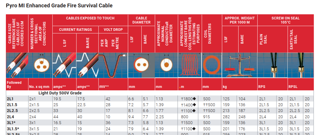

I have found a Pyrotenax label with a code but Pyrotenax tech support are ignoring me. Based on the only spec sheet I can find (attached) and by measuring the other exposed cables I can find in the flat, I'm pretty sure it's at least 500v 2L2.5 2.5mm pyrotenax which appears to be rated at 33a for "cables exposed to touch" which of course mine isn't - it's under the screed everywhere apart from at the consumer unit. I don't know if that means it can handle more than 33a or less. Anyone?
