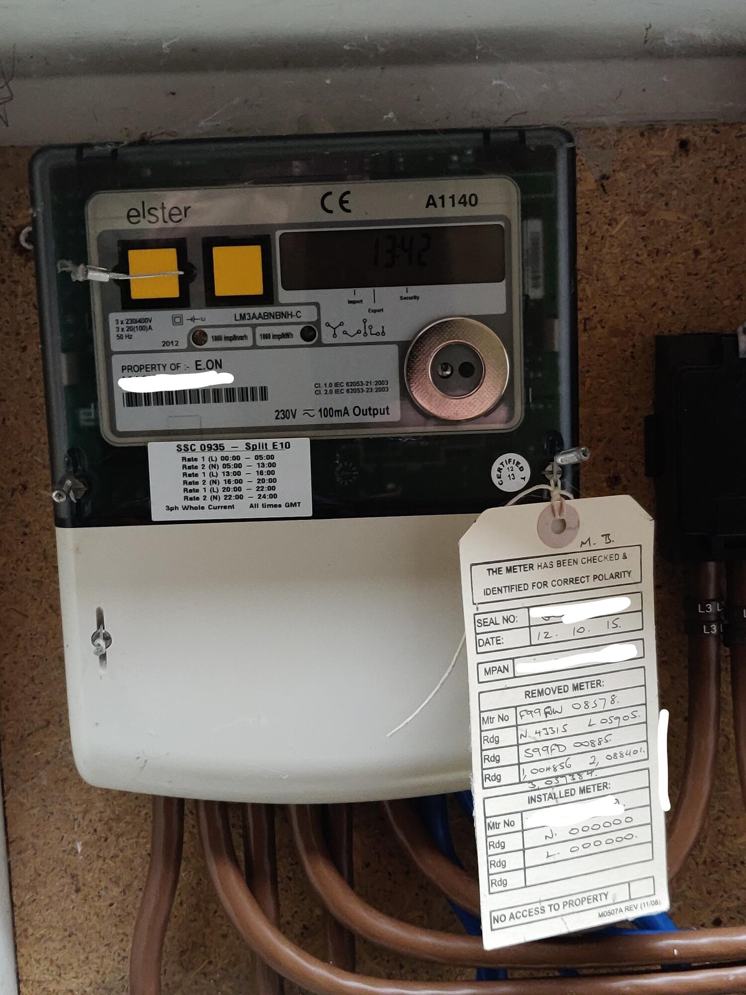

I have a question regarding the potential replacement of my existing EON supplied ELSTER A1140 3 phase meter which is currently providing E10 switching times for our all electric home.
The house has an old electric storage boiler and the system is set up such that I get 10 hours of off peak electricity for the boiler and one of two immersion heaters and also the rest of the house.
During peak times the house except boiler and immersion heater are use the higher rate.
This is an old Heatwise system from 2000.
EON Next have not been very helpful to clarify whether changing to a smart meter will give the same functionality as the existing system with 10 hours off peak supply and have an IHD or whether this would be different.
They just want me to book a smart meter install.
From other posts on this forum I understand that EON Next could replace my meter with a EDMI ES-30B 3 phase smart meter.
Does anyone on the forum have experience of such a change in a 3 phase system and whether this is straight forward.
Would the same off peak times be retained with such a change etc.
I know smart meters are the way forward but I have seen too many posts of home owners who have had problems following a change and I do not want to be one of them.
I have attached a couple of pictures of my meter and CU install, hopefully this will help.
Thanks
Peter

Hi wormcharmer
Having seen your second post on this subject today, I think you are coming to the correct conclusion hanging on to your present meter for as long as you can.
I had an E10 supply in an all electric property built in 2006/7 with electric thermal store UFH heating designed for E10. EDF was our supplier and we painlessly switched to an E10 smart meter with them about four years ago, but the scene seems to be changing now.
Fewer and fewer suppliers are offering E10 even on single phase. My impression is that you can't move to another supplier on E10 as none of them will offer E10 to new customers, even if they are supplying it for existing customers, and I'm not sure that EonNext will even offer an E10 rate now, however many phases you have!
If you sign up for a smart meter without certainty of E10, you will most likely end up on E7, judging from posts on the interweb!

Thanks Avo MK8 for your reply.
Interesting there are E10 smart meters out there at least from 4 years ago. I assume this was 3 phase.
EON Next are using the ploy that my meter is reaching its end of its life and needs to be replaced by a smart meter. It was installed in 2015 !
In a message from them in Sept regarding smart meters they said.
""Regards to your question on if we have a compatible meter for the E10 tariff.
The answer is not yet, however they are working on this as more people are wanting the tariff now.
Thank you for your paitence.""

You likely won’t have any legal standing and they can make these changes if they desire. It can be a hard one to take with suppliers, but sadly it’s their decision to make. Always worth checking though.
Thanks for your input.
I am going to stick with my current meter as long as possible as I have had no reassurance from anyone that changing to a smart meter for my 3 phase supply and E10 has been done before.

Surely the only difference is in the programming of the offpeak times and nothing else?! Suppliers are working hard to move everyone off of E10 and on to E7.
But half of the E10 off-peak is typically supplied during what are now 'peak' hours.
example
  • 3 off-peak hours in the afternoon (e.g. 1pm – 4pm)
  • 2 in the evening (e.g. 8pm – 10pm)
  • 5 overnight (e.g. midnight – 5am)
So for UFH heat store systems the store is topped up during the afternoon and again in the evening to keep the temperature up, and systems were designed around that.
To maintain performance of a heating system designed around E10, and be able to run it from E7, might require a larger store, more powerful immersion heaters, and/or running the store at higher temperature (more heat loss), or having to top up the existing system with peak rate power during the day.
You can surely understand why people with a satisfactorily working heating system get a bit miffed when their supplier wants to change the rules so it won't work as well unless you spend more money!
