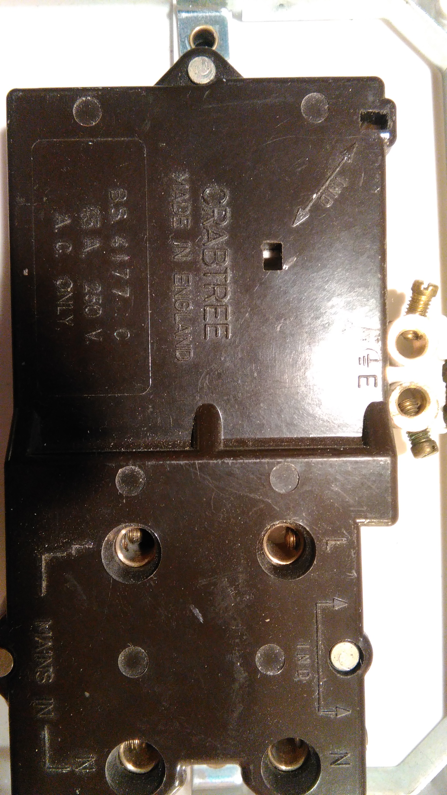

My first question is probably best created via the attached snap of the back of a CCU. There are two markings stating 'IND' and on the socket side two holes that appear to have some sort of conductive 'clamp' or connector.
Any ideas as to what these are / mean?

i'd think it was an obsolete 45A D/P switch, e.g for a cooker. the ind probably is for a neon indicator, across the load terminals.

The IND is probably indicator. i.e the little red LED/neon to show the power is on.
If there is a red window in the accessory then this is where the indicator should be, however the unit may be designed without an indicator lamp as it may be cheaper to make all the accessories, with or without lamps, from the same mould.

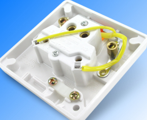

Agree with the above the old units used to have neon indicators fed by wires in i believe yellow sleeving
similar to this
