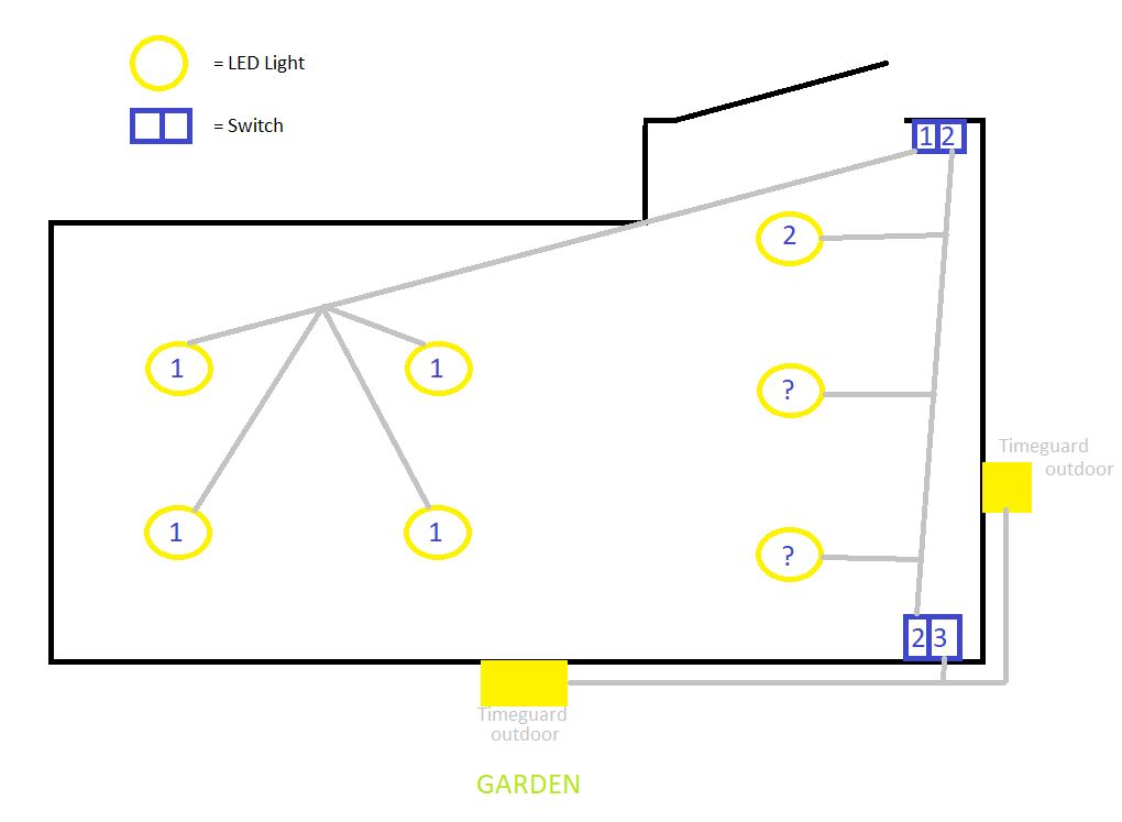

Hi guys,
I'm not a sparks so i'm looking for some advice and help on a few issues. I've recently had all my sockets chased back and new switches chased in and some replaced as well as other work.
My first issue. I've had all my sockets moved up a few inches from there original locations to accomodate for a normal height skirting board (i've got the lowest skirts you've ever seen. glorified bit of wood.) This has been fine, other than 1 socket i've been told can't be heightened. What are my options? The sparks has said the cable needs to be replaced with a longer length. I'm only needing to get 3 to 4 inches more from it. Is there anything i can do to get the extra length needed? otherwise having all the others raised was pointless.
Secondly, the big one. Recently since the light switches have been replaced i've seen some strange behaviour.
a) Kitchen lights (4 led's) turn themselves off. Sometimes turn themselves back on as well.
b) Lights in the lounge flicker when the kitchen lights are dimmed. I can recreate this by using the dimmer in 2 other rooms on the same circuit. Strangely all the upstairs dimmer and lights are the same and all work fine.
c) Yesterday, when using a blender (1560w) my fuse controlling downstairs sockets tripped when blending (this is the first time i've used it at this property)
It's worth noting that my kitchen lights seem to be on 2 circuits (4 on one circuit) 3 on another. On the circuit with 3 lights, only one works and the other 2 are faulty at the fitting.
Lastly,
I have had 2 x outside light installed. The sparks has recently fitted 2 TimeGuard outdoor PIR lights. The original owner had a 2 gang switch for 2 way switching of one set of the kitchen lights and (im assuming) a switch for the outside lights they had. Since the security lights have been swapped, the lights wont work when wired up to the 2nd gang of this switch. The sparks has disconnected the 2 way switching of the kitchen lights here as it's just not needed. When i first had them installed they tripped the CU 3 times within the hour. Strangely now they've settled and havn't done it since.
I've uploaded a pic for reference (apologies i'm at work!)
Sorry for the long post!
Any ideas?

Unfortunately your socket issue is not an easy one to fix properly. you could bury some connectors in a connector box in the wall - thats your quick and dodgy solution. however - this really isnt advisable at all and I wouldn't do that personally. Otherwise you would have to run a new cable from the last socket to that socket and on to the next socket.
As to the switches - it sounds fixable - just needs the right person with the right knowledge to sort it out..

Hopefully you agreed exactly what work you wanted doing before they started ideally they have seen the diagram you have posted.

Yup there part p registered, they have also asked me for clarification of anything i want done prior to the last visit. They've done 4 or so visits thus far, quick worker, no breaks or lunch. Work was all listed out in the quote. The diagram i just drew up crudely to give others a rough idea tbh for ideas. I have held back on the final payment for now.
So it seems my only option on the plug is to replace the cable. To be fair, that was what i was told.
Could the second issue with the lights potentially be amplified by changing standard switches over to dimmers? A the moment i have pendants throughout with dimmable LED's. And i meet the minimum load for the dimmer with all bulbs used so i don't think it's a kit issue. I am wondering however whether those 2 faulty kitchen ceiling lights could be interferring at all?
I am at a loss with the security light. If you guys were to troubleshoot the seccurity light issue, where would you start?
i'd start by identifying which cables were which, then ascertain if they were wired correctly. then alter anything that was wrong.
