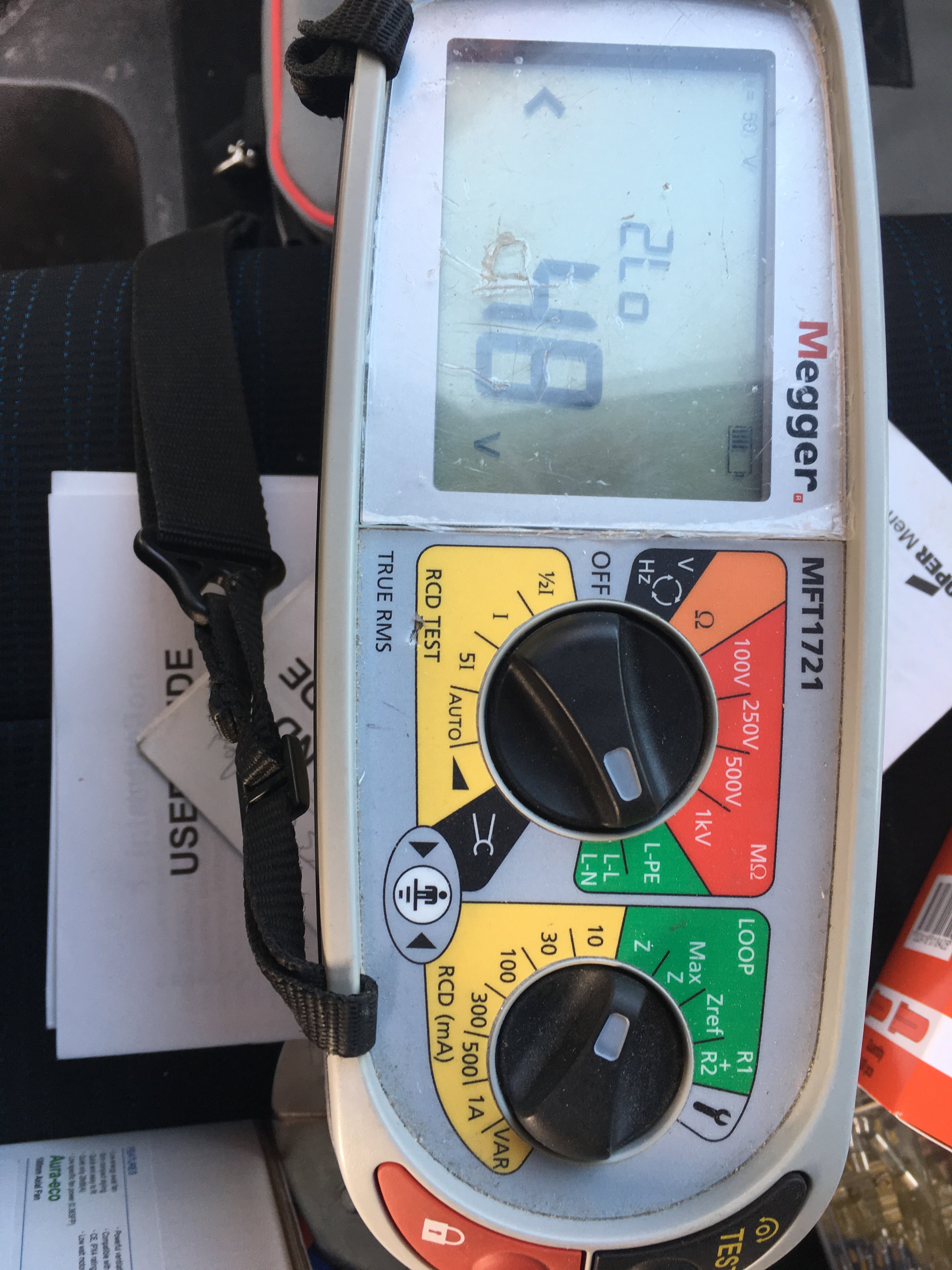

Left dial - L-PE Right dial - Z - it will come up as 3 Lo - if you select Z max i'll just keep the highest loop reading at the top rather than the PFC. All these settings are green
on the left you can select V in black, if you want to do a rotation test (not on MFT 1710) use Red probe L1 Green L2 and blue L3. any incorrect line sequence will display L1 L3 L2, correct will display L1 L2 L3.

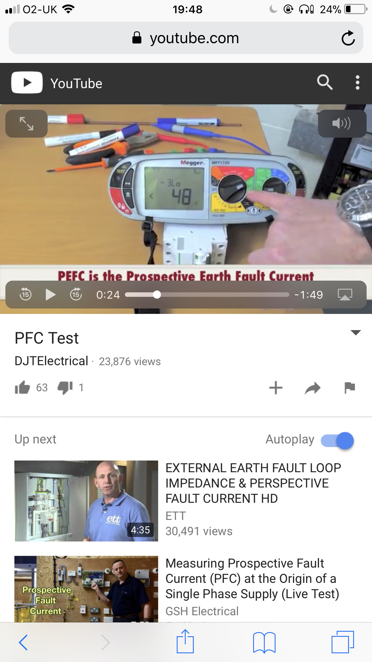

search Chris Kitcher on YouTube. He uses a Megger in his videos though not always an MFT, also you'll find it good reference for what you're doing.
Ah right Ive watched his videos hes good to watch.

Newer Meggers do have a low current, two lead test facility -

Ryan, you can test using two or three leads on low test, just making sure that you have selected the correct setting on your tester.
Using low test prevents the RCD from tripping, but readings tend to be a bit higher than when you test using the higher test current.

Ryan, I’ve shown the correct setting on the Megger in my earlier post ( photo). The two lead low test will not trip the rcd on any of the tests you are concerned about. Honest!

How would you measure pfc on that tester then?
