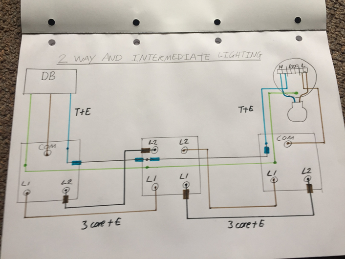

I know this has probably been asked a dozen times on this forum but I just want to make sure that I'm doing this the correct way before going into my exam. I got told that in the am2 I need to have neutrals at every switch in connecters. I have never done it this at work hence the confusion. Here is a diagram I nicked from a post a few months back.
Hi mate,
I wired my lighting circuit exactly like your diagram above. You're right, the neutrals need to be wired through the switches. Sometimes the layout/terminal identification on the intermediates can varying depending on the brands, so try not to let that throw you on the day.
Best of luck mate, you doing the Am2 or Am2s?
Not taking Neutrals to switches shouldn't mean a fail though ...
The point with the Am2 is that you are given a design and specification to work to, not following this correctly is a fail. So not taking the neutral to the switches as specified is a fail, the same as not complying with a specification in the real world means not getting paid and having to re-do the work correctly.
If part of the exam was to design the circuit then what you say would be correct.
with new smart switches etc. likely to become more commonplace, it would be a good thing going forward to install N at all switch locations when wiring new circuits.
