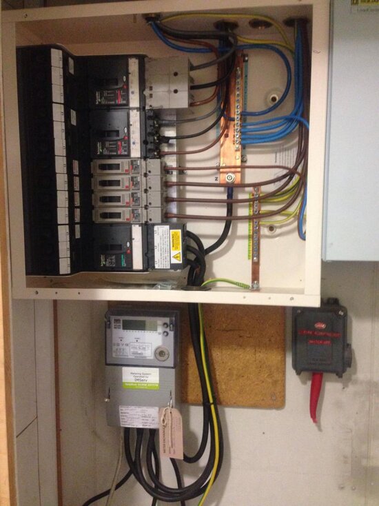

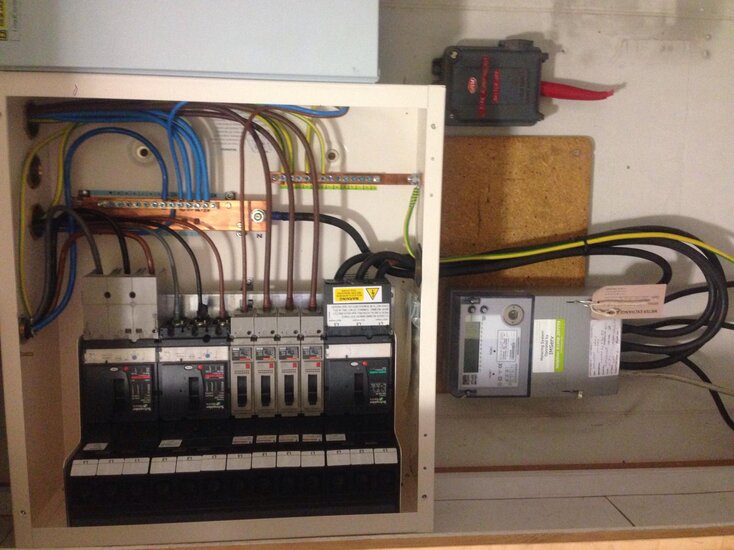

ive come to a job where it's got a single phase board and I need to change it to a 3 phase board due to new equipment going in.
ive gone back to the meter where the main control panel is that distributes supply's off to the sub boards and there is no spare ways for me to run a new supply.
Any ideas? I initially thought bigger control panel, but that involves a lot of work.
trying to load a pic of set up.

Can your supply cope with the additional loading you are planning?
Options replace with same model board with more ways so as to utilise the existing mccb's
Disconnect 3ph outputs (either 1 x 3ph mccb or 3 x 1phase mccb's) ... then feed another similar board off a new 3ph mccb in the space created and route the disconnected cables and new supply to your new board.
The meter only looks to be 100amp rated so I'd be checking on KVA demand.
As paul has pointed out if you are not experienced in 3ph or are a trainee then you need to leave this work alone or be supervised, this equipment is expensive and any errors you make can cost you, you may be competent but I'd be certain you know about this distribution systems as unlike domestic there is a lot of expensive lessons to trip you up.

that sounds like a good idea about using a current mccb as a supply to a new panel above my only problem is I have a gap of 350mm wide by 400mm high. Replacing the existing panel isn't an option because it would mean cutting power from the meter. I've not done it personally myself before.
Smallest panel suitable I could think of was to use a 4 way 3 phase board and have 2 63a supply's running through that but that is 470mm wide.
i have done a load test and its quite unbalanced at the minute, it would be more beneficial to put a 3 phase supply in to even it out, why there wasn't one put in in the first place I don't know. Single phase supply to commercial kitchen??
Any suggestions welcome.
It looks like you have a bit of room to the right of the meter, how much room have you got that side?
if there is room fit a suitable adaptable box and put the tails form the meter inside. Use the box as a bus bar chamber and re-feed the existing board from it and a new small 3 phase board as well .

It would still require 1 point of isolation so if going down that route its best to have a main isolator on busbar chamber then off feeds to new circuit and existing powerboard... agree its hard to give too many ideas without a wider pic' from the OP and my route was avoiding any issue altering existing tails to powerboard.
