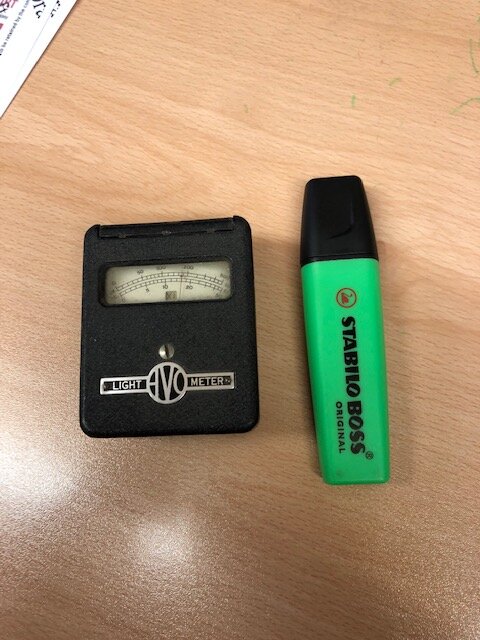

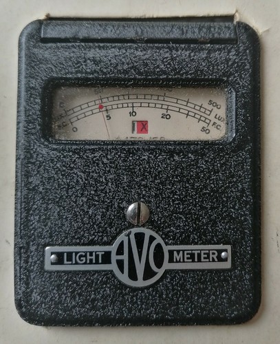

Came across this tiny old light meter tucked away in stores. There's a side button to change readings to X5.
Shame the input glass is broken...but it still gives reading.
It's getting on a bit......gives a light source factor for 'gas light'.
Zoom in on the last photo...... rating factor applied for different types of lighting.

Vintage light meters can drift as the selenium cell ages. There is usually enough adjustment to bring them back into calibration.
