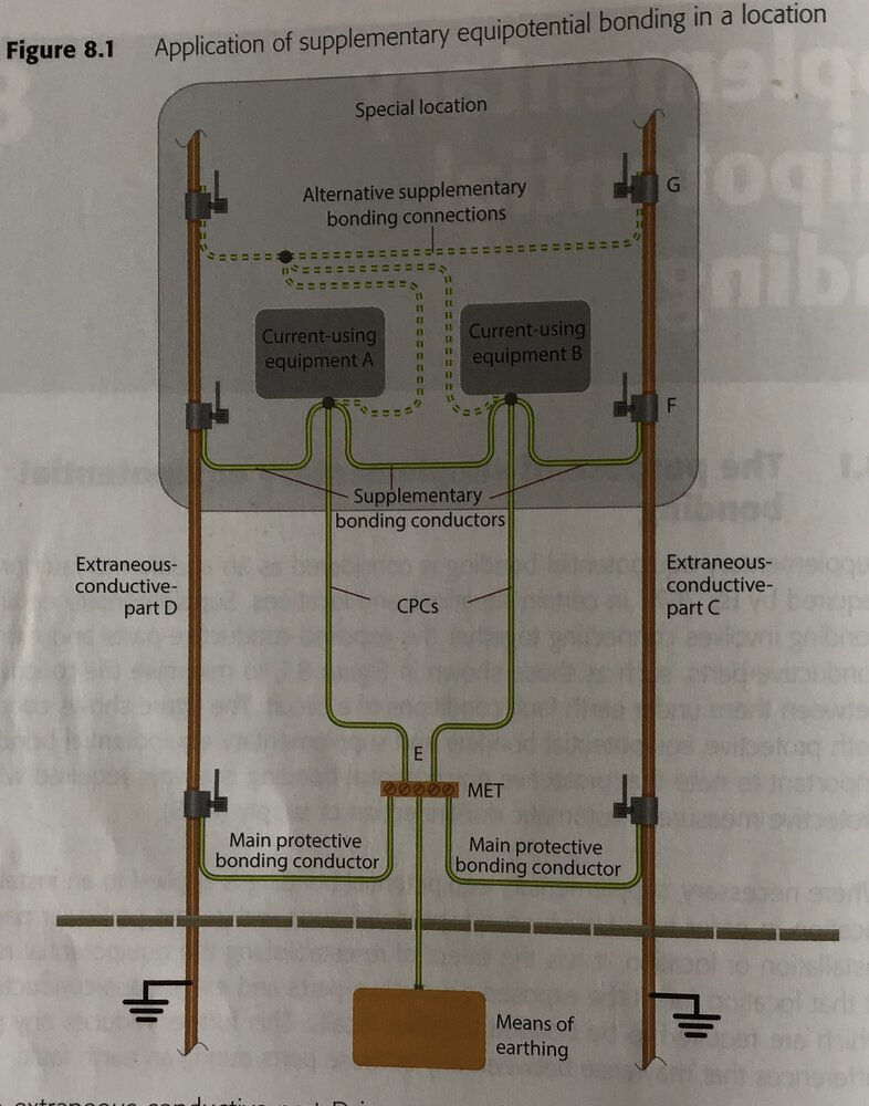

Condition report for a house, no RCD protection on the lighting in the bathroom so Code 3; the bathroom had the radiator and sink earth clamped.
Long lead back to the MET and got a reading of 0.04ohms... brilliant right?
I submitted my report and got a phone call later and my boss told me because it's not bonded to a circuit within the bathroom the regs say it's not good enough.
Is this correct and if so are you seriously telling me that 0.04ohms back to the MET isn't sufficient enough?
If I'm wrong in any of this let me know and explain it please as I really do prefer a good discussion

So I would say you need to test between the shower cpc and the extraneous parts to see if they meet the requirements of 415.2.2. From there you can decide C2 or C3
Hi - the supplementary bonding is in addition to the protective bonding that you’ve likely measured, if I’ve understood correctly. The light circuit cpc and shower circuit cpc should be locally linked to the radiator etc for supplementary bonding.

If supplementary bonding in a bathroom is applicable then Bathroom supplementary bonding needs to connect together the terminals of the protective conductor of each circuit supplying class 1 and class 2 equipment and to the accessible extraneous conductive parts (water pipes etc) or if there’s no extraneous parts then each circuit only that serves the location.
The wording is "equipotential" meaning everything inside the bathroom needs to be bonded together with as short a length of cable as possible.... not via the MET.
Sometime in the future, a length of heating pipe may be replaced with a plastic fitting. There goes any continuity back to the MET

After reading the replies iv'e come to understand what is meant now, essentially even though we create the House as one big potential zone as we earth everything back to the MET, we also create another equipotential zone within the house i.e the bathroom to further reduce the risk of shock.
My understanding was that if its bonded back to the MET with such a low reading then in the event of a potential it would be fine but i can see that its a box within a box to further reduce the risks.
Ian, would that mean that the shower circuit and the lighting circuit would need to have their CPCs connected with a single earth between the two as to create the above diagram Wilko posted?
meaning the fact they go to the MET is not good enough and need to be connected within the equipotential zone aswell?

Yes each circuit is required to connected together
What do you mean Ian1981?
If supplementary bonding is required then each circuit serving the location is required to have a connection between the cpc terminals of any class 1 and class 2 accessories/equipment and to any accessible extraneous pipework, water etc.
