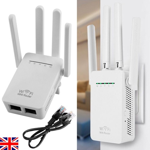

Good afternoon legends,
Just after some advice on what the title suggests really as I don’t do much data work.
I’m about to start a garage conversion for a client, and they’ve asked for a data point so they can get internet in there as the garage is detached, and the wifi ain’t that great outdoors due to thick walls etc...
What’s the best / easiest way to go about this?
Thanks in advance.
Like above I use cat 5e SWA from house router to outbuilding, terminate to a rj45 socket plate, then if you want to create a new Wi-Fi zone in the outbuilding, plug one of these in to it
Thanks for the advice geezers, it’s appreciated. 👍
They’ve dropped this on me as an extra, so I’ll price up, and let them know.
