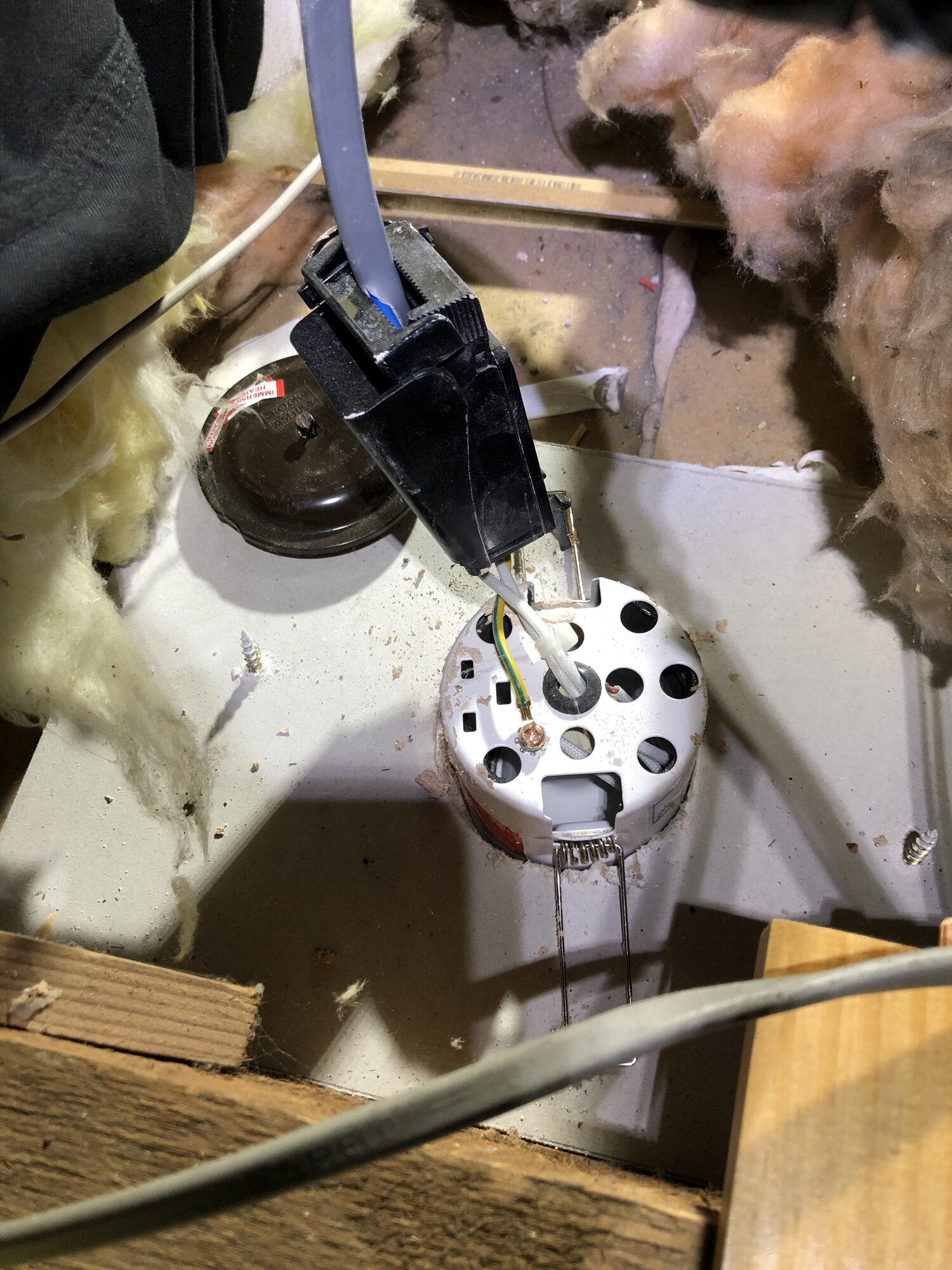

Up in a loft after an EICR carrying out rectifications including this beauty.
  • Class 1 downlight no earth lazy instal 56FFF8F2-809F-4E64-A183-4AA00E9BFBE7 - EletriciansForums.net

Hi all
It’s installs like these when you really loose the will to live.
At least you have pics & proof why do people do this,rewire C2 this looks like.
Now to check others.
