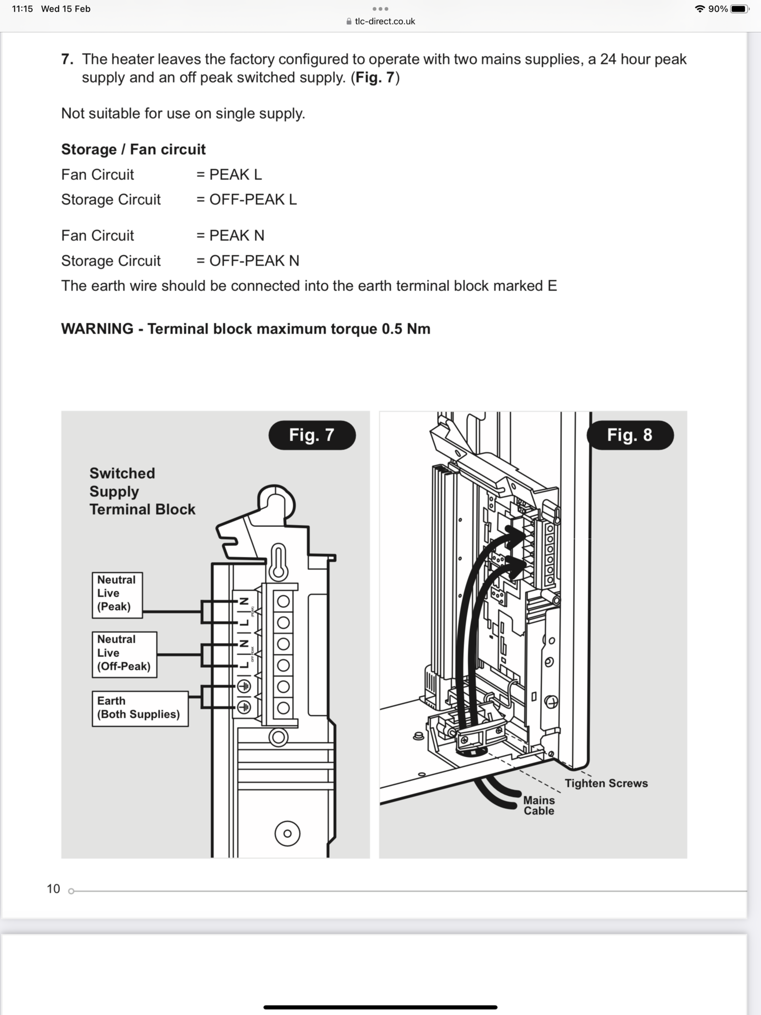

My electrician removed an old Creda storage heater connected to only 1 off peak supply and installed the SSHE070 but as the power is off peak he cannot set it up.
He connected it up but it has not come on over the off peak period.
Has he missed something?
He asked me to contact Dimplex but no phone number and the online "ticket submission" is no good.
Please can anyone help with this issue I have.
Thanks.
Yes your electrician has missed the fact this heater needs a permanent mains supply as well as the off peak supply
The instructions say:
You need the electrician back to connect it correctly!

The on-peak supply probably feeds a timer/control unit and a fan. The off peak supply will power the heating elements, but I suspect the on-peak is needed for the control unit to work, which seems to be borne out by your experience that it doesn't do anything with just the off-peak connected. I'll see what info there is on this.....

You might want to read up on the operation of the controller if you haven't already!
I couldn't immediately see any definitive statement about on-peak power being necessary for it to work, but given the circuit block diagram at the back showing the heating elements apparently controlled through the pcb, I suspect you do need both supplies.

The 24 hour supply doesn't have to be a separate circuit. If there's a socket nearby, it may be possible to spur from it.
All of the the storage heaters I've fitted recently need two supplies due to the need for compliance with the Lot20 directive.
Some can be run on just a 24 hour supply, but as baldy says, it can be tricky to set it up properly.
