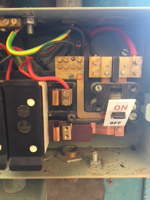

We should go back to double screwed terminals.....it'd give everybody two chances of getting at least one right. Like these, maybe. :cool:
