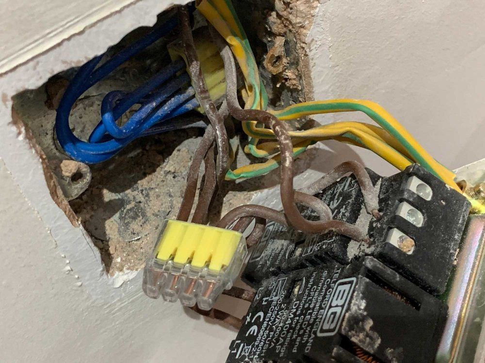

I called an electrician (different one to the one who installed the lights). He looked at the back of the switches and said that the wiring is done in an unusual manner in that rather than the lighting circuit branching off in the ceiling, the live wires for a few rooms come to one of the rooms and then they branch off from there. (see the attached photo) So you actually see the live and neutral wires behind the dimmers, rather than the live and the switched live coming from the lights. He said the cause is that as I turn the dimmer in one room, it is creating some sort of "power pull" and is causing lights in other rooms to flicker.
He said that not only is it unusual to wire this way but there is so many wires in the metal box that wires are getting a bit cramped in there.
To be honest I am not sure what difference it makes whether the live wires branch off in the ceiling or in the box. Not sure whether he meant the cause is the dimmer is between live and the light rather than being between the light and the neutral.
Anyway he said if I change to a on/off toggle switch (rather than a dimmer) the problem should go away.

Yes it does. I had an electrician come over and check the situation out. Please see my new reply (with a photo) for what he said. Thanks.

There's nothing obviously wrong with the style of wiring, it's quite normal these days to bring the neutral to the switch, but didn't used to be the case some years ago. Perhaps your electrician is old school. I doubt that is the reason for lights in neighbouring rooms flickering though.
I believe he is correct that there is compatibility problem with the dimmer and lamps, those BG dimmers are leading edge dimmers and so not compatible with all LEDs. I expect changing them to an on/off switch, or compatible dimmer modules will sort the problem.

Appletree - did the electrician actually use his eyes to study the wiring in the image? I suspect not. If one looks carefully at the two brown wires which are middle top and pass downwards once can see that the insulation on the left of the two has been scraped away revealing a small area of the copper conductor. I think there is similar damage to the right hand brown conductor - and I looks to me as if they may have been touching at these points before the switch plate was moved forward. Both these brown conductors are switched lives. The right hand one goes to L2 and almost certainly the left hand one goes to L2 on the other dimmer.
So, please take another look and take some photos from a different angle to confirm my observations. You will need some brown sleeving to cover the damaged areas. DON'T GO STICKING YOUR FINGERS IN WITHOUT TURNING OFF THE ELECTRICITY FIRST
