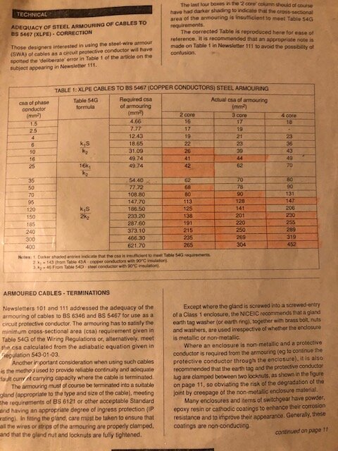

1. 160A MCCB the max Zs for this particular switch is 0.25 ohms all tested and I’m getting 0.44 ohms its a 95 SWA outgoing which feeds another panel which has its own outgoing circuits would I be right and say that would be a code 2? As I can’t meet disconnection time on it
2. Can’t meet disconnection times for various circuits 63A MCBs no RCD protection would you code 2? Max Zs should be 0.69 ohms and I’m in the 1.00 ohms

What sort of PSSC are you seeing relative to the PFC?
Those sort of numbers imply a significantly higher CPC impedance than the neutral or the voltage drop is going to be missed by a significant margin.
If it is down to the SWA armour impedance being too high (or rubbish connection to the glands/banjos), then to get the CPC impedance down a supplementary run of copper conductor along side together with decent connections at the ends might be a simpler/cheaper overall fix than changing to RCDs.

Yes, that would be right. According to the Best Practice Guide #4 it is C2 for:
Earth fault loop impedance value greater than that required for operation of the protective device within the time prescribed in the version of BS 7671/IEE/IET Wiring Regulations or manufacturers’ published data current at the time of installation
As a carven park I guess most end circuits have RCDs anyway, so you could deal with the (probably) high R2 by going to delay RCDs and/or a delay RCD add-on to the MCCB, but first it would be worth finding out if it is simply too much cable/not enough armour, or if there is some crappy gland use to be fixed.

I was just unsure as the 160A MCCB feeds the panel with 63A MCBs but the Max Zs is higher than the Max Zs of the 160A MCCB thought it was a C2
Is it feeding just the internal bus of the panel? I.e. there is no cables longer than 3m coming from the MCCB?
If so then the issue is one of meeting disconnection times on the 63A outgoing circuit MCBs, as the MCCB is only needed for overall overload of the system if (as is likely) the sum of MCBs exceeds the supply capability. I.e. no C2 code on the MCCB as it is not providing earth fault protection anyway.

If the MCCB is feeding stuff beyond a well-protected cable less than 3m in length then it ought to meet fault to earth disconnection times.
I was thinking of a MCCB incomer to a board: in that case the MCCB need not meet disconnection on its own, as all circuits ought to be met by the outgoing MCBs' protection.
