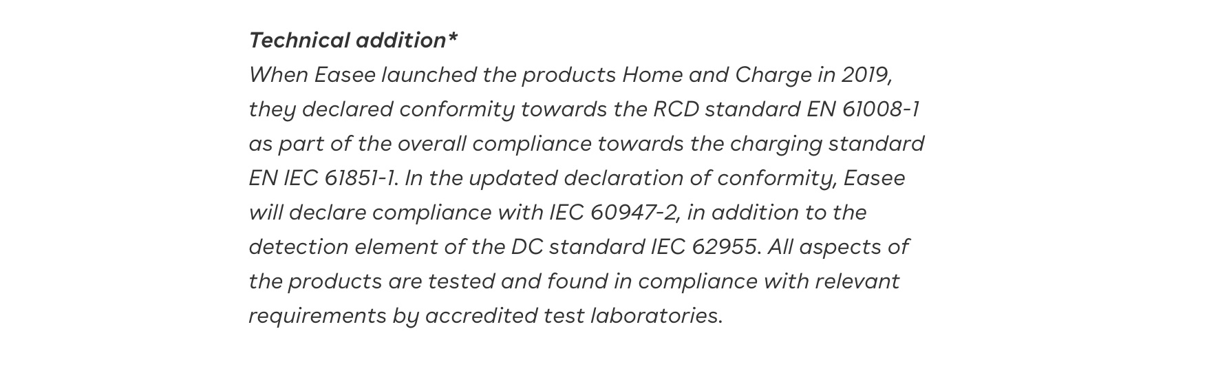

Google AI declares the Easee RCD as being compliant with BS610081 etc, but no references.
Not being convinced, I had a further look, which revealed this... does it help?
In summary:
In summary:
Don't forget they faced a sales ban in Sweden and their native Norway for lying about the nature of this "RCD". You definitely need to install one. It absolutely and categorically is not a BS EN 61008 or BS EN 61009 device in the EVSE.
I did wonder!
From the blurb that says it does an auto test, I assume it must be a sort of 'electronic equivalent' to mimic the characteristics of an EN61008 etc device, but not physically of traditional RCD form (and therefore not amenable to approval to that standard)
I've just had a look for the latest version of the Certificate of Conformity for the Easee One, which was issued on 21st May this year, and regarding the RCD it says this:
Residual direct current detecting device (RDC-DD) complying with IEC 62955, clause 9.9
I don't know the details of what that implies, other than the fact they can't claim compliance with the traditional RCD device standards.
I have come across this, which seems to be a description of the protection system aimed at installers
https://download.easee.com/m/31bc990e0654fd3a/original/A2g_RDC-DD Functional_Description_EN.pdf
The above does include the gem: "The charging station shall be installed with an external RCD Type A in the fixed installation."
The Easee certification claims compliance with the Electric Vehicle Charging standard, EN IEC 61851-1:2019, which embodies electrical safety, and they also claim compliance with the standard for Circuit Breakers IEC 60947-2:2016+A1:2019 (which includes those with a re-closing function),
There appears to have been type testing by TUV for this particular design of residual current circuitry, so it seems they can now legitimately CE mark the product and sell it as safe!
So following the mantra of selecting a CE approved product, and following manufacturers instructions, you could argue that despite the lack of BS EN 61008 certification for residual current circuitry, it has an alternative type approval for the bespoke device within it, so you wouldn't be doing anything wrong by installing or using it! (Except some parts of the manufacturers documentation/instructions seem to contradict each other!)
Yes exactly, the RDC-DD is fine allowing use of Type A dedicated RCD interrupting all live conductors instead of Type B. It may mimic RCD functionality, but is not really an RCD - certainly not to either BS EN 61008 or BS EN 61009. It's a common problem with many EVSEs, but they shouldn't misrepresent what the internal device is.
