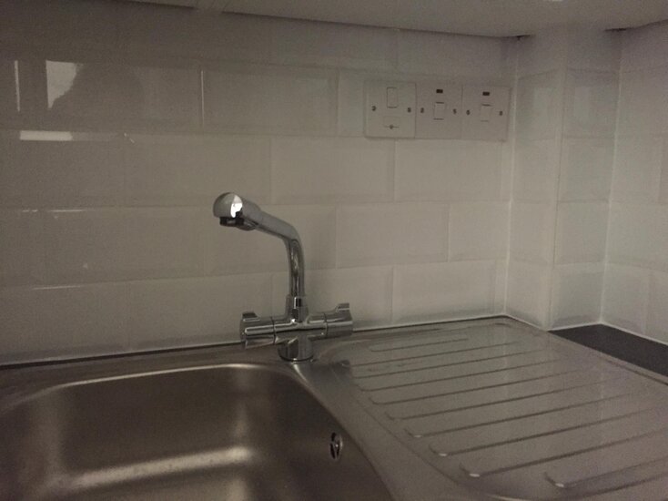

Oh right fair enough. I was more thinking along the lines of potential splashing, operation with wet hands/sink full of water and mainly no RCD protection? If it's harsh though I haven't filled out the EICR yet lol
if they's been socket outlets, a C2 would then be appropriate.
