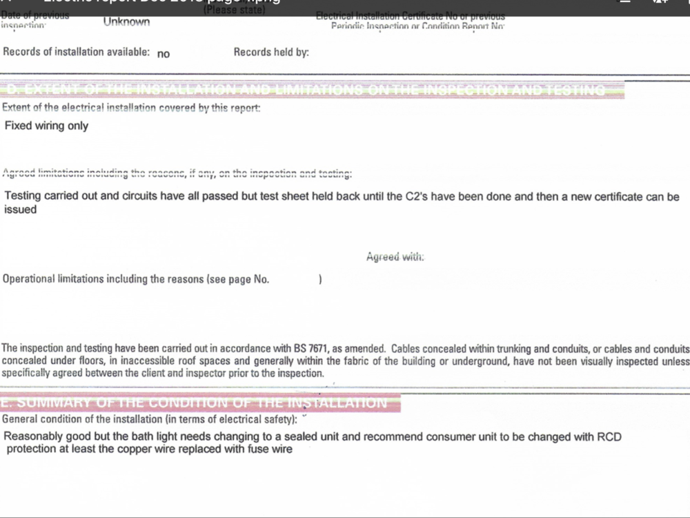

A customer has asked me to quote for some work and he sent a copy of the EICR that was done a while back. As can be seen, the person who did the eicr is holding back the test results until the C2's have been resolved?

he says all circuits have "passed" so why are there C2's?
Just carp!
I dont like the scope 'fixed wiring' - so he did the TV aerial also??
'Condition' - 'reasonably good' since when has that been electrical terminology?
Also refers to the EICR as a 'certificate' :(
Erm,
I have just read the last line of the page.
So is he saying, that he pulled a fuse, saw that it was hard wired with copper wire and then put it back in?
It is not a person with good moral standards I feel.
Fuse wire replaced with copper?...….and then he puts the fuse carrier back in place, totally disregarding circuit protection... AND admits to doing it by including it in a report.
Absolute jerk.
