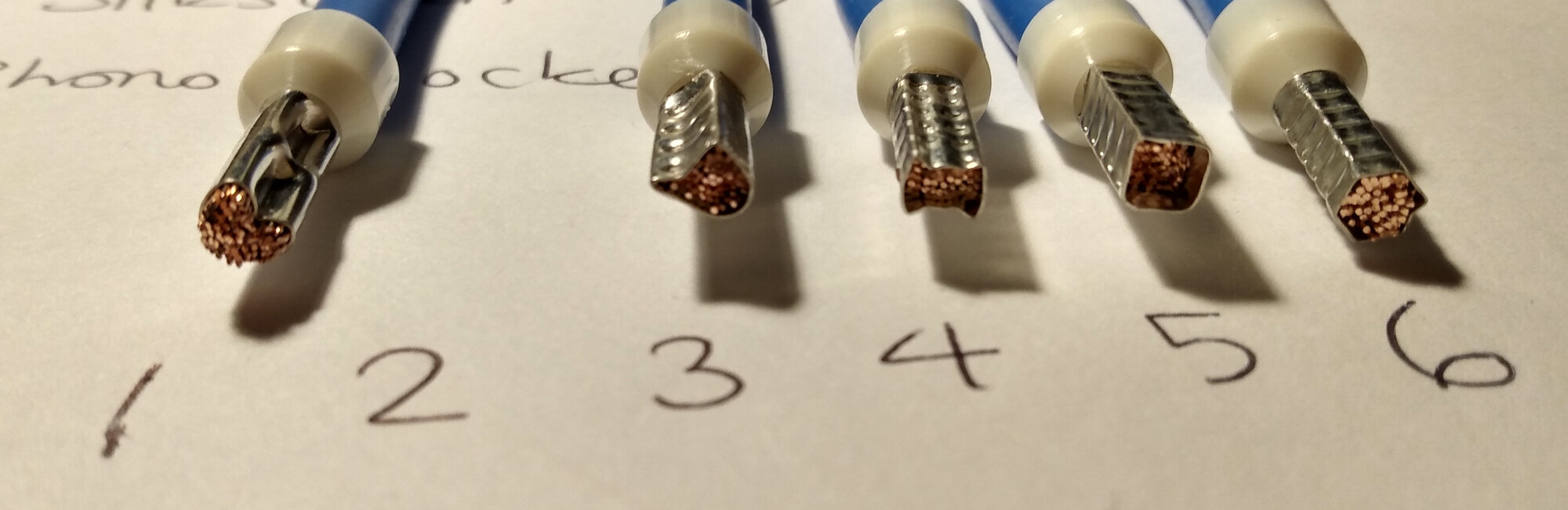

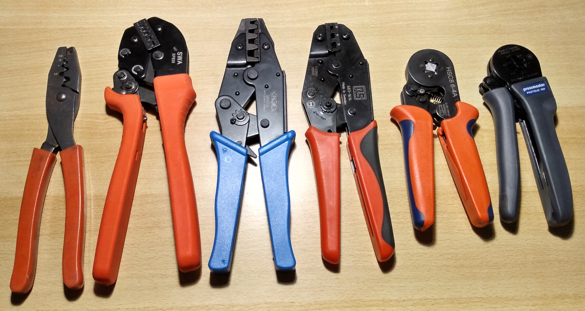

We often see folk asking about which crimp tool to buy/use so I decided to round up my collection and put them to the test. Ladies and gentlemen, here are the usual suspects:Ferrule crimp tools part deux ferrule-crimp-tools - EletriciansForums.net
Seems I cant post after the image? From the left we have:
First test was with 10mm tri-rated wire, fine stranded and all but the SWA tool could do this:
Ferrule crimp tools part deux 10mm-ferrules - EletriciansForums.net
Results were:
  1. For the simple Maun/RS tool it was easy but really needed two crimps for the 10mm ferrule.
  2. N/A [SWA tool limited to 6mm]
  3. The Engex crimp was tight, but lop-sided and stuck in the die
  4. The RS tool did a great job for this size (also for 16 & 25 elsewhere)
  5. The cheap Chinese tool work fine here
  6. The Expensive hex-die did a good crimp, but needed quite a firm hand force to complete.

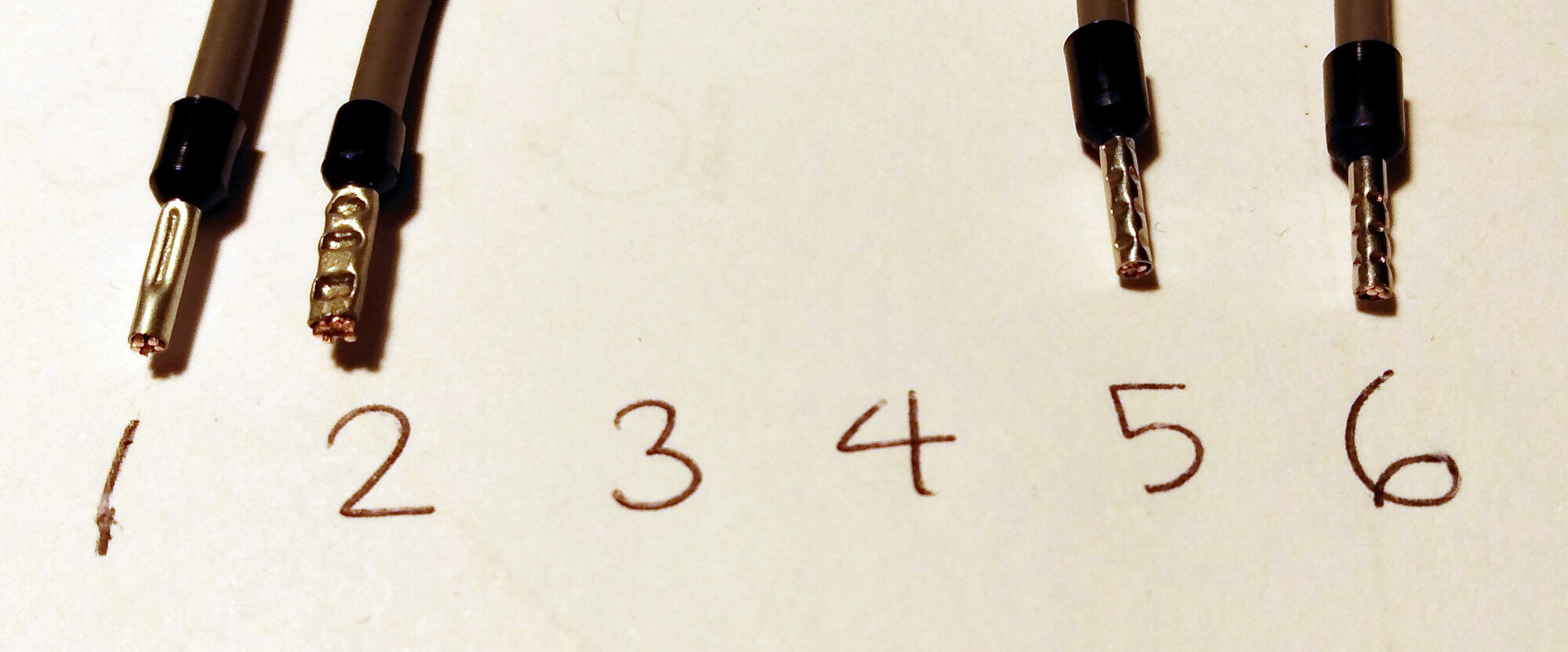

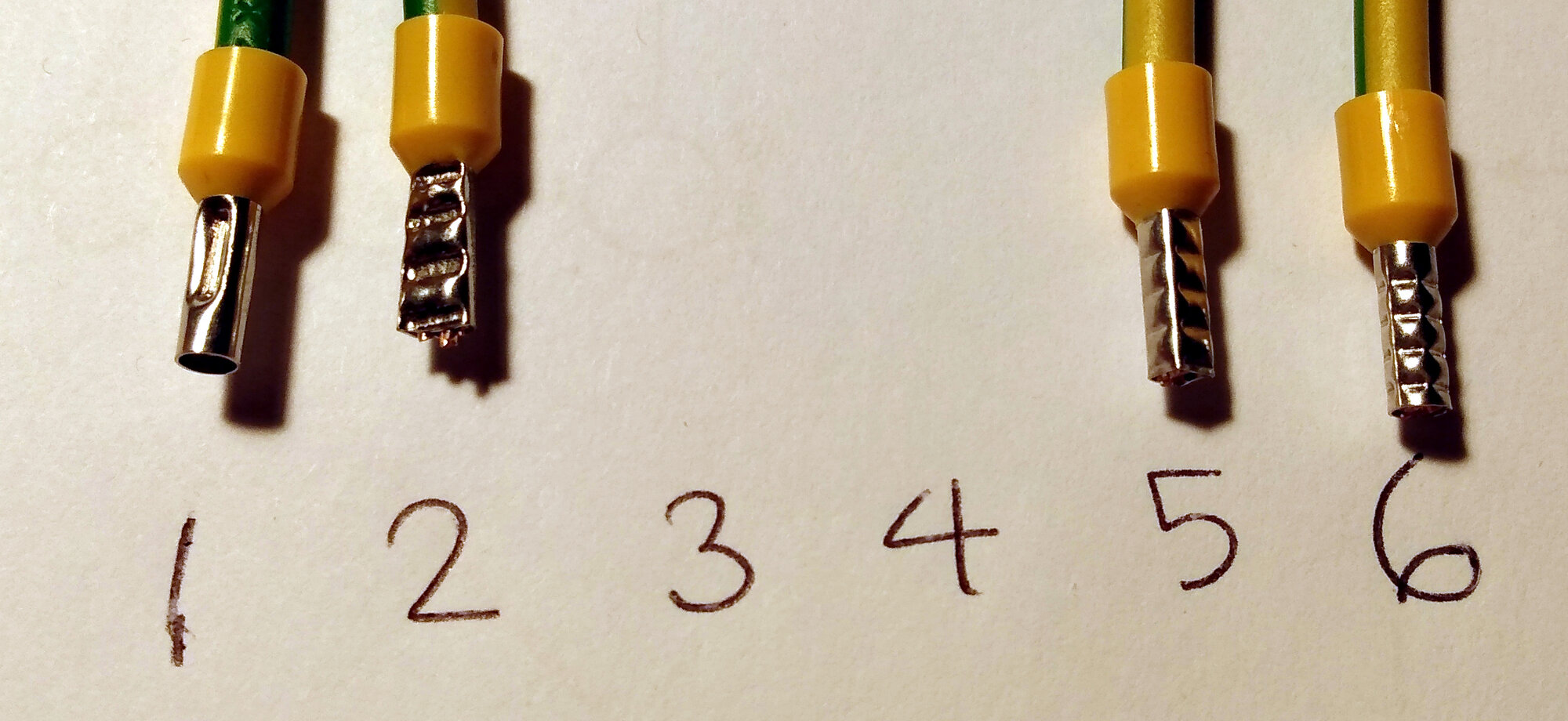

Next we have 4mm 7-stranded conduit wire:
Ferrule crimp tools part deux 4mm-ferruls - EletriciansForums.net
  1. Again the old RS/Maun tool was simple and easy
  2. The SWA tool over-crimped a bit, tight in jaw but otherwise tolerable
  3. N/A (below Engex range)
  4. N/A (below RS range)
  5. Again the cheap tool was fine
  6. Hex tool also fine, though firm force still needed

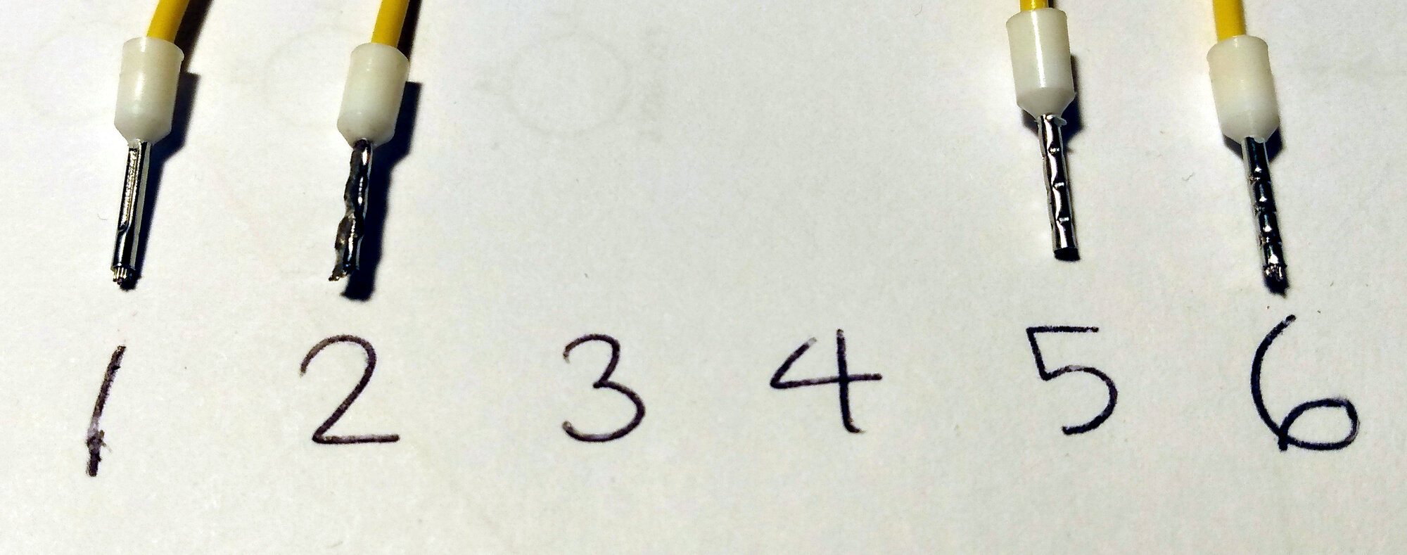

Then 0.5mm fine stranded wire:
Ferrule crimp tools part deux 0.5mm-ferrules - EletriciansForums.net
This was the smallest for tools 1 & 2 and well within tools 5 & 6 rating
  1. Old RS/Maun tool fine
  2. SWA tool over-crimped, also getting easy to end up in gaps between correct crimp locations
  3. N/A (below range)
  4. N/A (below range)
  5. OK, moved a bit when pulled but not easily coming out
  6. Perfectly good

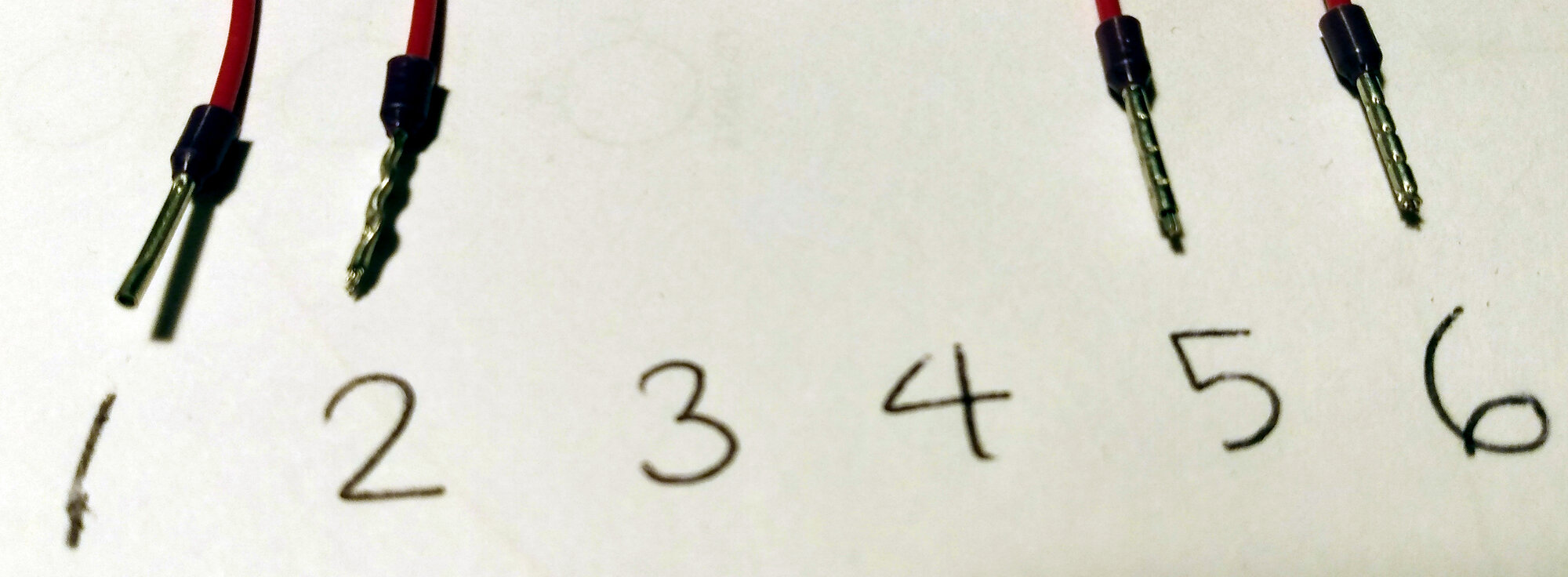

Finally 0.25mm fine-stranded wire (violet ferrules, not obvious in photo):
Ferrule crimp tools part deux 0.25mm-ferrules - EletriciansForums.net
This is within tools 5 & 6 range, but below tools 1 & 2
  1. Old RS/Maun was OK, moved a bit if pulled but stayed in
  2. SWA over-crimped significantly
  3. N/A
  4. N/A
  5. Cheap eBay failed, crimp looks OK but wire pulled out easily
  6. Expensive hex die was perfect
Conclusions?
  1. Well for all is basic appearance, the Maun tool is really good, but you need to get the right gap. However, adjacent gaps don't really lead to a stuck wire.
  2. The SWA tool is pretty rubbish. Having tried it a few times I really would bin it.
  3. Same for the Engex tool. While it does above the 16mm max of the Maun, it is not great.
  4. The RS tool is very good for all 3 sizes (10-25mm), but expensive
  5. The cheap eBay self-adjusting tool is great for 0.75-10mm and excellent value for money. Doubt it will last the 50,000 cycles RS/Pressmaster offer but at that price hardly worth complaining about. Not great at 0.5mm or below.
  6. The Pressmaster is good, but harder to use for the upper range and also expensive. If you are doing a lot of small ferrules (e.g. instruments, some control panel signal wiring) it makes sense, but hard to justify the total cost.
Over to you ladies and gentlemen to share your own experience....
