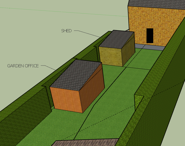

I am thinking about running some cables in the garden. The idea is to electrify the garden.
My idea is to run some electrical cables so I have
a). lights
b). electricity
There is a plan to build a shed or garden office at the end of the garden - about 40 meters away from the house.
The whole area will need some landscaping so I thought while I move the earth around it would be good to dig a long trench across the property and lie some cables.
One cable would be for the insulated sockets for the garden (future pergola ~half way into the garden),
another cable for some lights and 3rd for the shed.
I don't think I will need anything out of ordinary e.g. high wattage power tools.
In terms of lighting I think 2 options to lit the 1st half and all lights.
What cables should I order?
Thanks

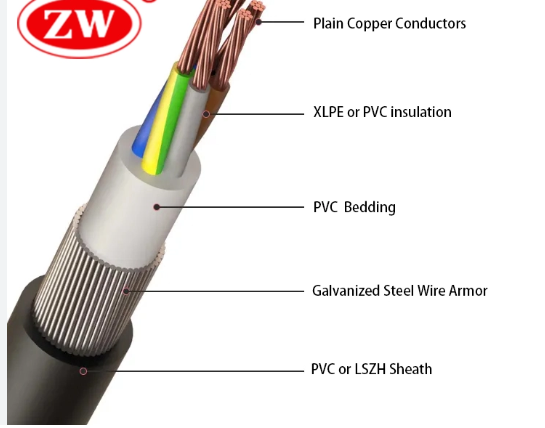

Traditionally if you wanted power from the house to the far end of the garden it would be one fair sized armoured cable buried in the ground on its own circuit
Sometimes you needed to put in a couple additional cables for switching but with wireless stuff now you don't need to these days
Hi again, it was quite a while but this is what I want.
The consumer unit is just above the black door.
I am in the process of replacing these doors to PVC and was wondering how these wires should be run.
The frame is going to be replaced so it would be good to make some preparation to avoid unnecessary drilling later on.
Should I just fit some piece of pipe in the lower corner between the frame and wall so the wires can go through?
Re wiring itself I have asked some electrician about this but I think he has no imagination for garden wiring especially when none of the building are standing, I think I need to consult this with someone who has done something like that. I think the wires has to be ordered by the electrician himself because it also get cheaper.
