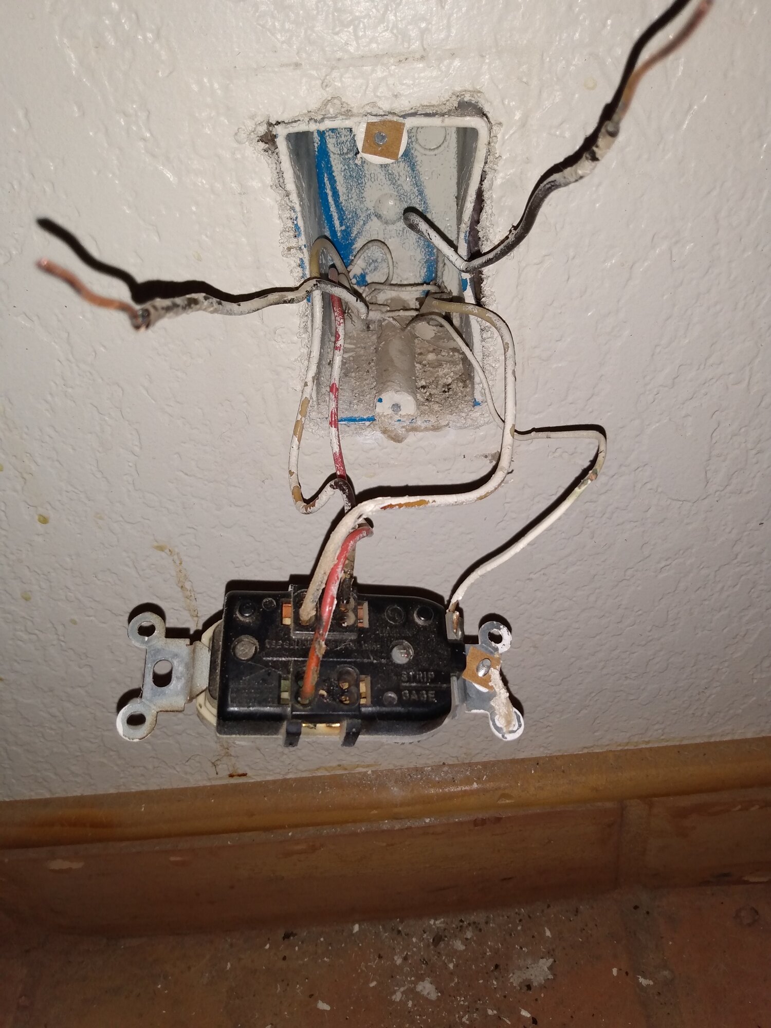

This started about two months ago. I went into my master bathroom, turned on the lights, and they immediately went off. Tried the switch a couple of times, nothing. The hall bathroom is on the same circuit along with a wall outlet in the master bedroom and the hall light. I tried all of them, nothing. The hall bathroom has a GFCI. I poked the test and reset switches, nothing. I checked the circuit breaker, switched it off, back on, nothing. Replaced the circuit breaker (easy, cheap), still nothing. I was working on other projects so I put up a couple of motion detector lights in the bathrooms. No biggie. I'm single, nobody to complain.
A couple of weeks later, on a routine visit to the bathroom, I forget myself and flip the light switch out of habit. The lights went on. Checked the other bathroom, lights went on. Checked the hall light and bedroom outlet, everything works.

A few weeks go by. I go to the bathroom flip the light switch and the lights go right off. Made the rounds, poked the GFCI, nothing, circuit's dead. OK, I'll get to it one of these days. Still no biggie using the motion detector lights.
Today, a little while ago, I used the hall bathroom, with the motion detector lights. I walked out of the bathroom and my brain says, "Whoa, back up, the little lights in the wall switches are on." Flipped the switch and the lights go on, as does everything else in the circuit.
Ideas, please.
Sounds like an ordinary bad connection, somewhere near the beginning of the circuit. A loose wirenut, a cable not quite under the head of the screw, or something like that.
Easy to find using continuity tests with an ohmmeter when it is not working, harder when it is, but a systematic search, based on the order the circuit passes through the various switches and outlets, will probably find it in the one nearest the panel.

I have to agree with @Lucien that somewhere in you circuit has to have a loose connection and as Lucien stated it’s probably a wire nut that’s not making a good connection. Good luck
I have to admit I procrastinated on this. I had other projects and the motion lights in the bathroom did fine. This week I found the suspect outlet. Not by trial and error but by accident. I plugged a cell phone charger into a wall outlet in the living room. That wall is shared by the bathrooms. As soon as I plugged it in the circuit went live. When I wiggled the plug the circuit went on and off.
When I took out the outlet I found what you see in the picture. The two black wires had slipped out of the holes in the back of the outlet. I put them back in the holes but one of them slipped right out so I am replacing the outlet it with an outlet that has screws on the sides.
First question is why does it appear that the end of one of the white wires is painted black? If not painted, is it burned? Either way, just wanted to confirm that the two disconnected black wires go on the hot side of the outlet (brass) and the other two go on the white side (silver).
Second question. When I turned off the breaker to that circuit several lights and outlets at the opposite side of the room went off. Those lights and outlets had been on all the time that the bathroom lights were off. In other words it appears that only half of the circuit was protected by the GFCI and the other half wasn't. It's as if wiring was routed from a power source through several lights and outlets and then routed to a GFCI and, in turn, routed to the bathrooms and wall. Is that what happened?

Arizona let me guess the white wires was the loose wires because the white Wire is burned and that part needs cutting off. It has lost its ability to conduct electricity
Just to add to what Megawatt said - those black wires don't look very good either, the copper is seriously tarnished and it appears to me as if the hole they came from on the back is a bit scorched.
The outlet should be replaced and all of the wires cut back a little and stripped so you have clean conductors and insulation that is not burned/brittle. If the wires are not long enough to reliably be made good then you need to get them replaced.
Poor connections are a real fire risk - even with arc-fault devices (and similar)!

Arizona the way a house is wired they are a good bit of loads on just 1 circuit it sounds like the loads that went off when you turned the breaker off which You was not having problems with was ahead of the receptacle where you was having problems. That’s the answer to your question.

Replaced the outlet. Stripped back the wires for clean ends. All fixed.
