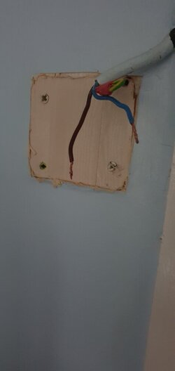

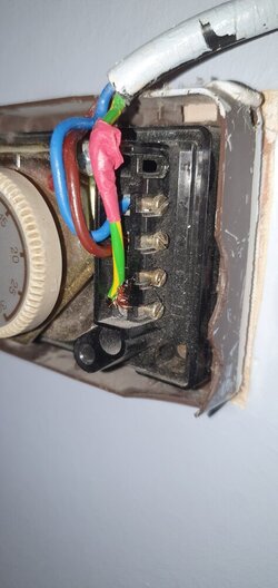

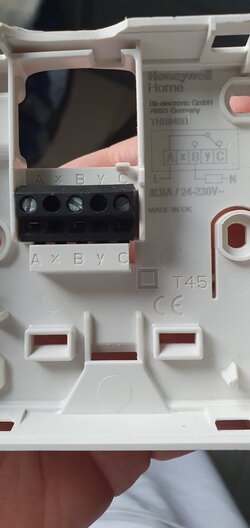

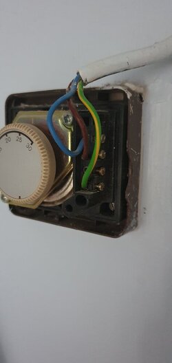

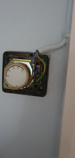

I've purchased the Honeywell DT2 digital Thermostat to replace my old analogue honeywell one. I have a brown (live), blue (neutral) and earth. I have connected the Live to A on the Thermostat and the neutral to B. The thermostat clicks and kicks in but doesn't turn my boiler on. I've also swapped the wires around but no luck and the instructions are too complicated for a DIYer like me.
Can anyone assist please?? Photos below
https://www.dropbox.com/s/5ymldsrqz8158z1/20201128_151632.jpg?dl=0
https://www.dropbox.com/s/8rhtdzbyfeljjkm/20201128_150450.jpg?dl=020201128_150450.jpg20201128_151632.jpg
If you definitely only have the brown and blue ignoring the earth then blue is not neutral. Connect blue to C but only if you definitely have a brown and blue.
Ignore my earlier post. Where was the earth connected at the old stat as it has red tape on it indicating it has been used as a live or it is just taped up to keep it out of the way.
Looks like someone has used the green/yellow (earth) as the live return. Not ideal but if the earth is connected to C it should function. Ensure blue is in B and brown in A.

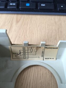

The old Honeywell thermostat needed a neutral as it has a small heater resistor to reduce the hysteresis of the bimetallic strip. Photo below of the connections. From that the grn/yel wire appears to be permanent live in, the brown wire switched live to the boiler, and blue neutral.
But the new Honeywell Home thermostat, from the OP's picture, is battery powered and acts effectively as just a switch, and doesn't require a neutral.
So I think the green/yellow should go to terminal A, and the brown to terminal B, and the neutral safely terminated and not connected to the new thermostat at all.
Karatekid - does the lid of your old thermostat have the same diagram in it as the pic below, or any other info about which terminal is which? I do believe what you have called the 'earth' wire is very likely to be mains live, so I don't recommend experimenting until we are more certain of exactly which wire is which.

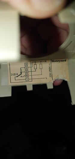

Yes its exactly the same inside. The earth is connected to number 1 on thr old stat. Ignore the red tape, I put that on.16066551562301553595109920947786.jpg16066552059751398104757489997067.jpg
OK, thanks for that.
Well unless the original owner didn't wire it correctly, that indicates your grn/yellow wire is mains live (so keep the red tape on it - or make it brown!), and the brown is the switched feed to the boiler. Those are the only two you need to connect to your new thermostat. As per my post grn/yel to 'A', brown to 'B', insulate the blue and don't connect it.
It would be wise to check this hypothesis first. Do you have a multimeter to check volts on the 'earth' wire? Care needed obviously.
Given that the old thermostat connected grn/yel to brown to make the boiler work, I believe the above will work.

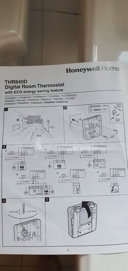

This is battery powered to the only live in is from the programmer.
i cannot get a copy of the install manual as the Honeywell site is not providing it.
Do you have a copy?

It works!!!! Green/yellow into A and Brown into B with Blue blocked off thank you!!!
