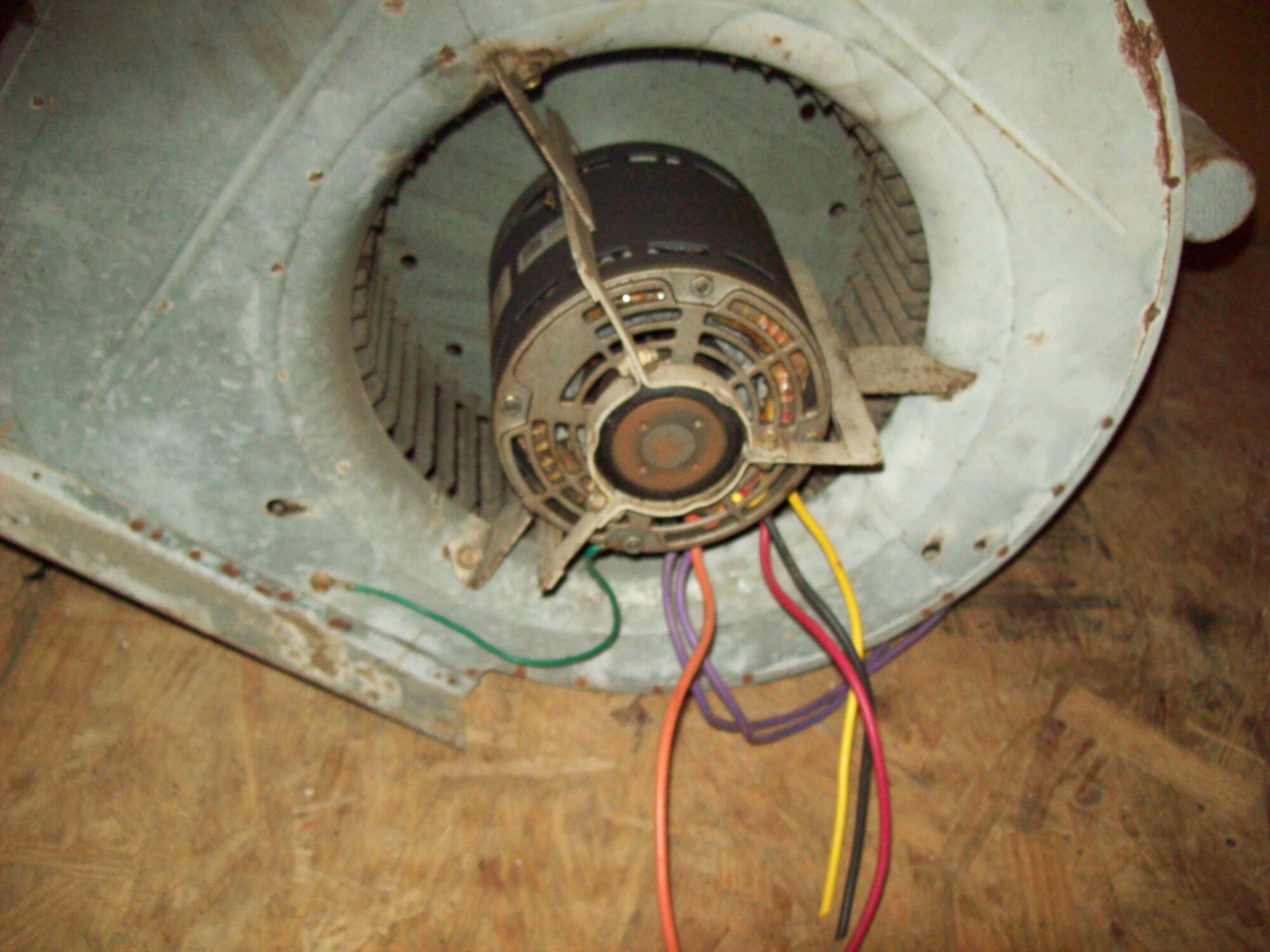

I've got an old furnace fan I kept the last time mine was replaced. I'd like to use it for various purposes. It has a red, black, yellow and orange wire. Also a purple going to/from I'm guessing a capacitor on the side and a green ground wire. Can I wire it up to be used on 110v ? I have 220v available if required. Also how would I control the speed? I'm guessing it had various levels.

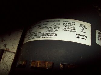

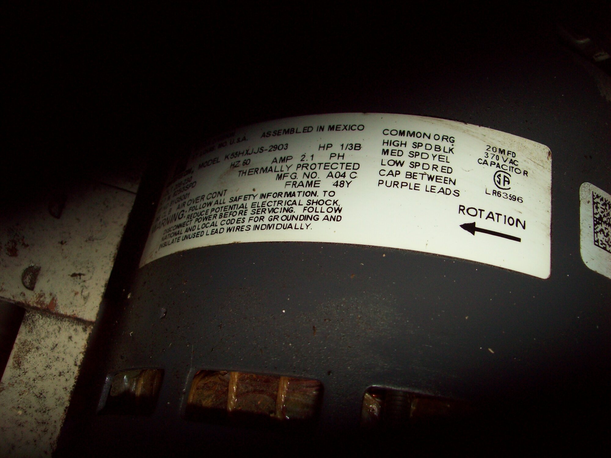

I believe you're onto something. Here's the label.

So would that mean I would wire a 110v white wire to the orange common and hot wire to whichever of the other 3 based on the speed I want?
Yes, don't forget that the unused speed wires will need to be safely insulated if they are not used as there will likely be voltage on them. If the motor has had a lot of use it would also be worthwhile replacing the capacitor.

A couple of the wires determine what RPM’s you want it to run. The problem is that we don’t have a diagram to tell us what wire does what.
If you zoom in on the photo of the label it tells you which wire is which.
Two problems, you will need a step down transformer and the motor is designed for 60Hz, so the magnetising current would be higher causing saturation. It's not worth the hassle.
