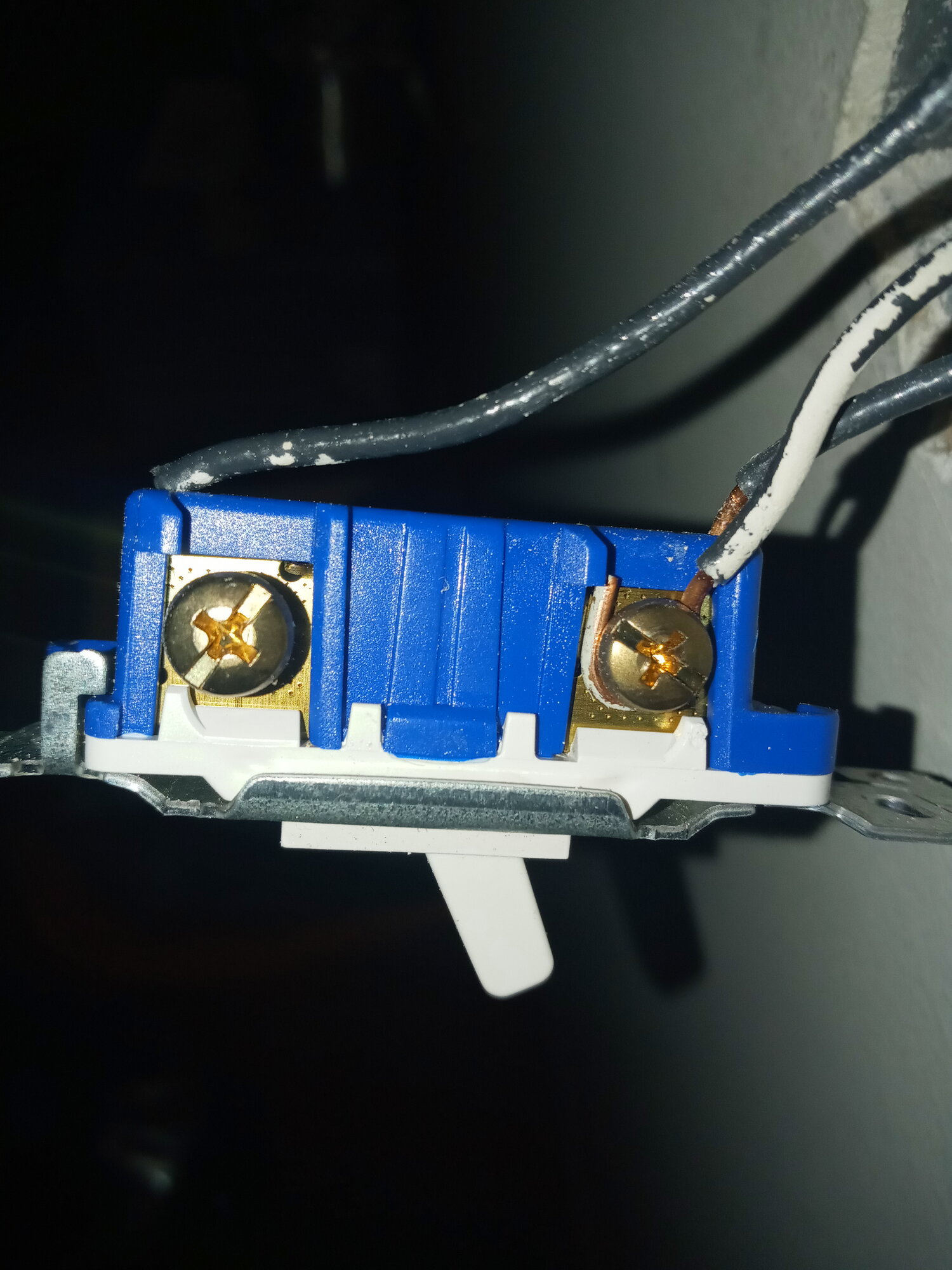

First post to this forum so bear with me.
So i am hoping to put an outlet in a spare closet so I can plug in various items and have them out of the way...
Ive watched a few videos and none of them have so many wires coming into the box.. This box has three and three black wires to the switch.. two quick connected and one using one of the only two screws that are on the side both of which are gold. ..This kind of threw me off..
So I am just looking for advice on how I would go about wiring a standard power outlet directly below this light switch that is inside a walk in closet. Or if its even plausible
Any advice would be great.
Thanks

The two blacks are almost certainly the permanent hot, hot in hot out. So your hot needs connecting to those, neutral into the whites and ground to the bare wires. As opposed to trying to fit another hot to the two blacks I would connect them to a wire nut just leaving the one black to the switch. So your two blacks, the black to the receptacle and another black reinstated to the switch. Might be easier to fit a combined switch with receptacle. Is the circuit GFCI protected bit out of my knowledge whether it needs it @Megawatt will confirm.
the one connected to the screw is also black, it just has paint on it.. i scratched it off to confirm.. Pretty confusing. So I need to potentially disconnect one of the blacks from the quick connect (unsure how to do so) and connect it to the black from the outlet I want to add below this switch? I would like the power at the outlet to be on all the time regardless of switch position.
From your first picture in #3 disconnect the lower black by pushing a small screwdriver into the slot by the wire this should allow removal, ensure power is off. Make safe and see if the light it switched on no longer switches on.

Yes you can use the wires you have. First the black wire by itself on the switch is the hot the 2 wires on the bottom obviously turns on some lights. They make a receptacle/ switch that you could use and still have your switch plus a single receptacle.

Yes you can add a duplex receptacle. The whites are your neutrals and you will have to take the hot wire loose on the switch and with a wire nut and tie the hot black with 2 black wires to feed your switch and receptacle. All the white wires under that wire nut are your neutrals and remember the other white is you switch leg

I tested this outlet with a multimeter. why are there two hots going into the switch? Any idea?

Im not necessarily out of my depth, I just like to have a good understanding on a topic before getting into a project, especially with electrical work which can be dangerous. Appreciate the concern though. Everyone is being pretty helpful, and I understand electrical work is one of those things where you kinda have to be there and with limited info can be dangerous to give advice. Considering just replacing the switch with a receptacle/switch combo instead... How would I wire that? :)
removed the wire from the screw and the kitchen light ---- off, so I reconnected it and turned off the kitchen light switch and tested the wire again and it was still 120.. not sure if that determines anything... pretty sure the wire on the left side is going to the ceiling fixture in the closet to power the light bulbsHow do i wire an outlet off of this switch? 20210615_112HDR - Copy - EletriciansForums.net
Both those blacks are probably hot, hot in and hot out. One is on the screw the other the stab terminal if this is the case see #4.

if i go witha combo switch / receptacle instead I would like to wire it so that the receptacle is always on. what would i need to do differently if that is to work?
