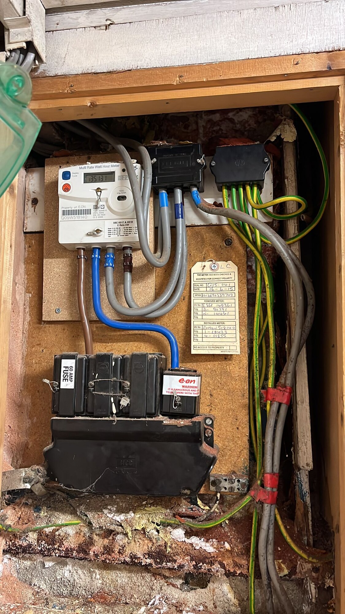

Hello, we're looking at relocating the CU fairly urgently for a small business (retail shop) and came across this service head. Obviously need to safely isolate ahead of working on the CU but not come across this type before. We're assuming the cut out is probably at least 50 or 60 years old although does look in surprisingly sound condition. The meter was replaced in 2015 and they didn't fit an isolator at the time.
If anyone is familiar with this type of cutout can you advise whether they're usually fuss-free to open or if we're likely to run into problems? Any tips from experience would be very welcome!
Plan B is disconnecting the meter <> Henley tails with the next stop being fitting an isolator before anything else.
Reason for the urgency is that the wall behind where the CU's located is in pretty dire condition & damp which has led to corrosion within the CU.. not a pretty sight and long overdue for replacement along with a partial rewire.
Thanks!

Just looks like a 3P&N service head that is only utilising 1phase.
Looks like a TNS earthing arrangement, but there is a lot of detritus around that area. Testing should identify if it’s true TNS.
Probably got a 1361 60 amp fuse in the cut out.

the cutout/fusecarrier looks fairly new to me and it has new colour tails that would have been 2004 onwards if i remember right.
50 to 60 years is in my opinion probably out by a good 30 years.

Based on the attached label the meter was replaced in 2015 and we're guessing the cutout - meter tails were changed then as they seem newer than the rest of the install. Prior to that the last major electrical work was to fit a new CU in around 1987 and apparently the cutout has never been worked on according to the owner; who's had the building for 47 years.

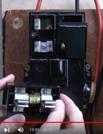

Looks like Henley Series 3 fuses on a BICC head. As you can see in that screengrab the terminals are not shrouded as they are in newer types e.g series 7 but other than that it's not very different.
