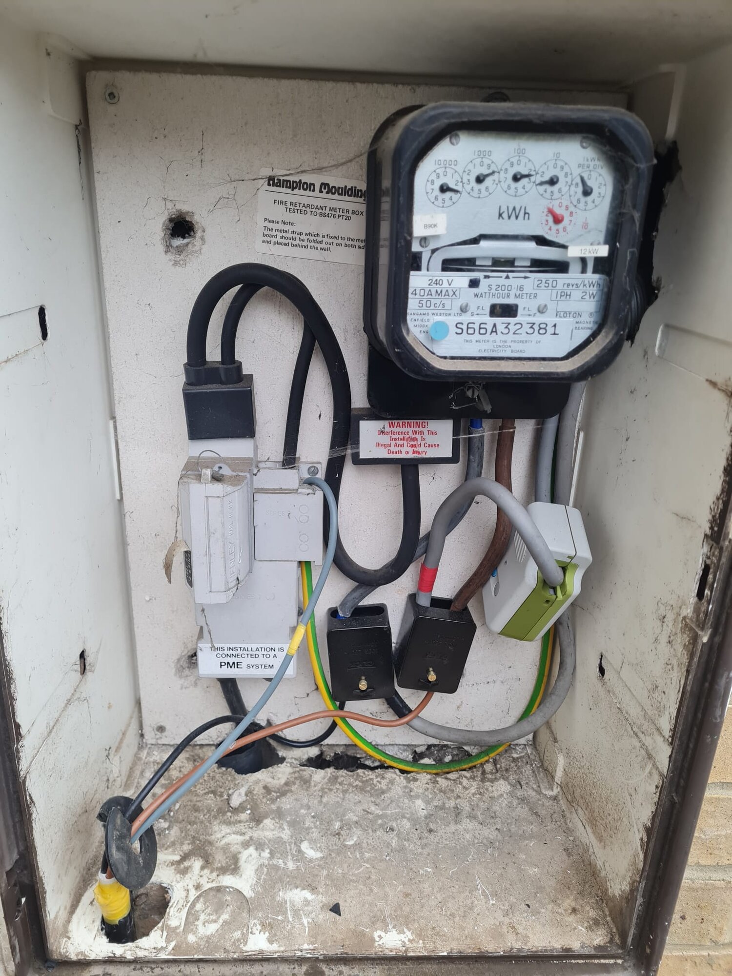

A friend of mine asked me to review the electrics on his new extension as he is not happy with the work. Here is what I found:
1. None of the back boxes are earthed. Not a failure but poor practice
2. Loose socket back box and broken light box (missing lug).
3. Ring main cable passing through back of lighting back box ( switch box is level with socket in kitchen).
4. Breakers labelled wrong on the new DB.
5. Live wire sticking out the wall with no termination block! I fixed this one as super dangerous.
6. Live wires sticking out the ceiling with no termination block. Also dangerous but out of reach. Not fixed.
7. Armoured cable missing gland and outer casing not earthed.
8. Light switch in bedroom not screwed in to back box. I fixed this one as dangerous.
Photos attached of some of these. The builder did the electrics and signed it all off. There are a number of issues with the extension- not just the electrics. If I was an inspector I would not have passed it! However, poor practice does not necessarily equate to a Part P failure. So my question is do any of the above actually constitute as a failure?
Thanks in advance,
Glenn

Sounds like your answering you’re own question. I’d be referring more to BS7671. Is this ‘builder’ a member of a scheme? How was the work notified? Leaving exposed live conductors!
What does that armoured cable connect to? The single insulation looks like it is exposed. I hope it's not going directly to the meter!

The builder is an approved NIC EIC contractor and he has issued the certificate. I just don't understand how he can issue it with live wires sticking out the wall!
And yes the armoured cable connects to the main 100A incomer.
I'm very tempted to report him.

If the builder/sparks has issued an installation certificate that implies all is compliant with BS7671 and within timescale for building regs, there is no reason why a Part P certificate wont be issued (Did it come straight from the builder/sparks?).
A building inspector wont re-inspect the works done.
Your only recourse is to report it to NICEIC but I dont hold out much hope of them getting involved unless perhaps you can stress how dangerous the live wire situation was.

Why not contact the contractor and raise the concerns you have with him first.
The Niceic will say the same thing.
