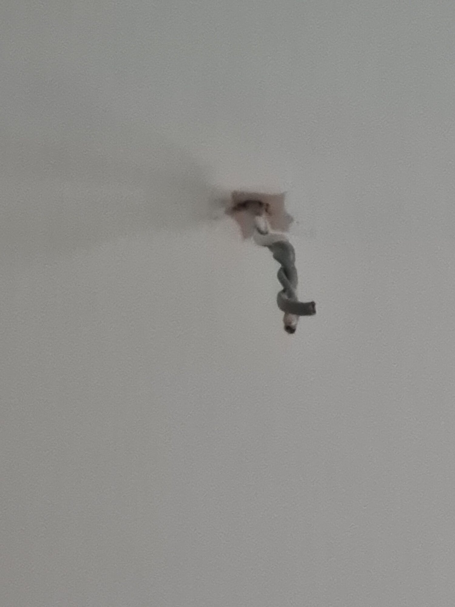

Thank you all very much for all your input. My 100A comment was without me actually checking. I wrongly assumed it was 100A as my 1930s house is 100A so assumed all houses are 100A. Good spot! I've not looked too closely at the DB the builder installed. Probably higher than 40A the way things are looking!
Anyway, more than enough ammo to go back to the builder. My mate still owes him money so told him to get an independent electrician in to fix everything and knock it off the bill.
Thanks again and Happy New Year to you all!
That's not very sensible advice. They should make a formal complaint and give the original contractor the opportunity to address the issues and put their work right.
They should take proper legal advice on this as there are procedures that should be followed.
If they follow your advice then your mate may well find that they are being taken to court by the original contractor for the withheld money.

I have had it on a couple dozen occasions where the builder knows full well that they fecked up the wiring and after a complaint from the homeowner and a strongly worded EICR from me they agree XYZ money off the building work to put all the electrics right. On small jobs this might be as little as ÂŁ500 but on some of the bigger jobs could be thousands to put right all the dodged wiring.
Get it all agreed in writing with the builder THEN get your own electrician of choice to put it all correct.
Probably tend to agree but how many get reported to NICEIC? I think mostly would get reported to the site agent.
Hopefully the NICEIC would act on one or two of them
It needs reporting so there is evidence.
The consumer needs to complain to the builder then if not success raise a complaint with the NICEIC.
However do not expect the NICEIC to resolve the matter.
Had exactly the same situation with a new build, the NICEIC used every loophole to avoid getting involved.

I looked at a new extension that a NIC DI had wired and on inspection there were live twisted cables slung in the loft with just a little twist of gaffa tape on them and I complained to the NIC this wasn't acceptable to leave a brand new install this way. The response was its the responibilty of the original electrician to come back and put right and nothing to do with them.
BPG4 issue 6 says otherwise.
Although, this is one instance where I disagree with BPG4, and agree with you. C2 any day of the week, as more often than not these meter cabinet doors are unlocked and left flapping in the summer breeze.
On the grounds that it's in an enclosure only accessible with a tool??
Does that mean it's OK for all the wires in a loft to be 6491X singles, as long as I put a screw in the loft hatch before leaving?
