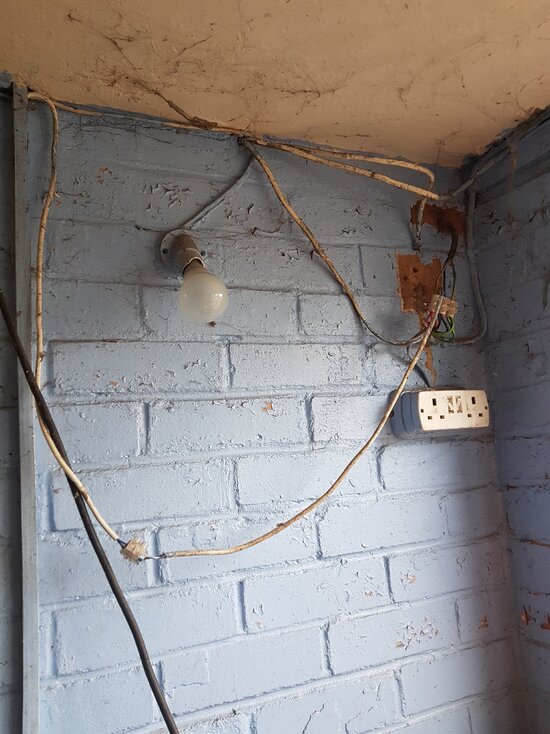

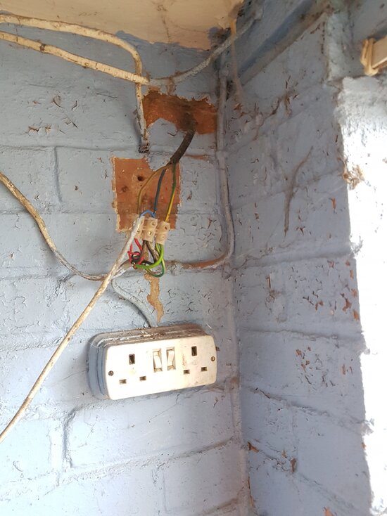

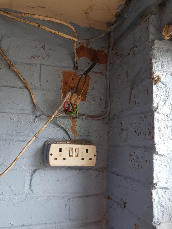

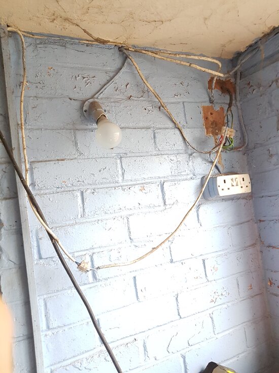

Come across in an eicr today...amongst other destroy it yourself jobs...
And when i ripped it out....
" Its safe cause it works mate i know what im doing".....
Ok...
Well he wasnt too happy with me ripping it out nor his other handy work.
As that was actually dogged off an inside socket and fed his garage and his garden which was under plastic roofing all of which id left (just ripped out the supply to it) that he'll only re do it. What do we know though hey?
If he wasn't happy with you ripping it out then who gave you permission to remove it?
