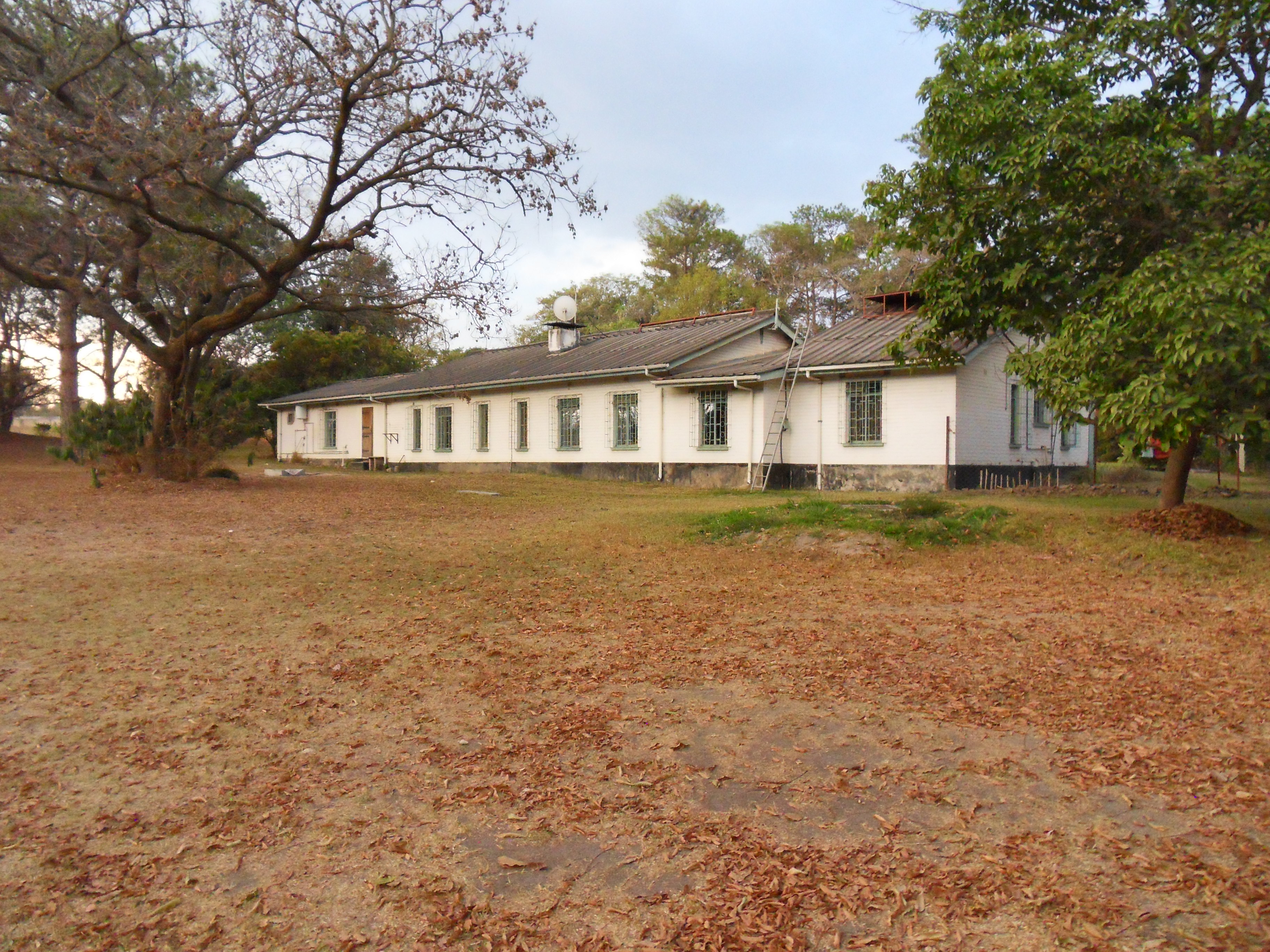

One thing I don’t understand is the practice of putting a short spike (air terminal) somewhere on the roof peak as in pic below of a Zambian church roof with its 50mm2 copper down tape. Seems to be that the 90% of the rest of the roof is outside the protected zone therefore, but I guess if you use tape along the ridge this can stop this problem. Maybe I am just not observing the tape there. It would be cheaper to put our spikes on the roof ridge if ridge tape and laying the down wire on the roof is OK. But as the roof angle is shallow will it cover well down to the eaves?
The reason the contractor was suggesting 13m poles next to the building is to get around this as it puts the spike higher than the building, albeit offset. Also if the roof is metal and the spike is on the peak, laying the down wire/tape down the roof exposes the roof to the surge, or is that not a problem? The roofs are linked to house earth but only at one sheet of many and I am sure the electrical resistance between each sheet is large.
What he recommends is 1 pole each next to the 2 single storey houses, one house is in pic below (that one is not a metal roof). With a 45ish protection angle it’s not going to cover the whole building, which is quite long, but I was aiming to get it as close as possible to the solar panels to at least cover those.
Then there is a group of 3 larger single storey buildings. If the 2 poles are in the small gaps between buildings they cover a bit either side. E.g. in this pic one pole would behind the solar panels behind the flag pole and in front of the green roof, which is another building spaced 3m away. I guess the new pole would be a bit higher than the flagpole. The other pole would be to the left behind the taller section as there is another building behind there. 1567876875252.png
Clearly a lot of roof is outside the 45ish degrees. But BSEN 62305 talks of catenary wires and so would it be a good idea to run them between the tops of both poles and on to the furthermost corners of the roofs? This could obviate the need for ridge wires. But they will use 16mm2 for all this and I can see it just vaporising. But your suggested Al tape can't be that thick at that price.

I have had a think about all this and come up with the attached which is my attempt to arrive at a lighting protection concept that is achievable in Africa considering the limited budgets usually available there. It includes some photos of "good" practice from Austria where I was last week. Before you scream at my incompetence please read the disclaimer at the end. Any constructive comments on it gratefully received.
I did a drawing of a rolling sphere for the house in the photo above and concluded that the proposed 13m pole beside the long roof edge would be OK for Level 2 protection (30m radius sphere) as long as we ran catenary wires from the top of the pole to the ends of the ridges, as the house would be otherwise unprotected all the way to the ends.
