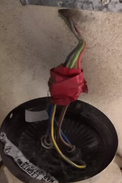

no problem with connecting to lighting circuit. you need to find if the neutral is at the light or at the switch. then your device needs a permanent L and a N. it's more common to have both at the light rather than at the switch. is the light a standard rose and pendant? can you post a pic. of the wiring at the light and at the switch?
Switch and Light photos attached. Is it probable there is a junction box somewhere else which means no power to switch and light is on or off so can't be used to run something perm?

Hi - likely the switch has L and two switched L, but I couldn’t see an N in the pic. You’ll need both L and N for a separate load from the light.
What does the manual say about fusing for the bridge?
If it's intended to be plugged into a socket then what size fuse is meant to go in the plug?
You have a problem.
The switch doesn’t have a neutral, the light doesn’t have a permanent live. You need both to power the module.
The switch appears to be part of a two-way circuit, so there may not even be a permanent live there!
The lighting circuit is an old type. It was then done by the cables being connected by a junction box hidden.....somewhere.
You need to investigate another power source.

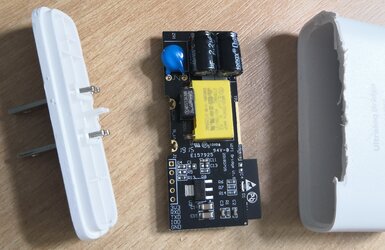

Thanks for your comments. It is a 2 way light switch. I opened up the bridge to see what was inside as I figured i'd be doing some soldering anyway. Picture attached. No fuse. The 2 prongs attach directly to the board.
