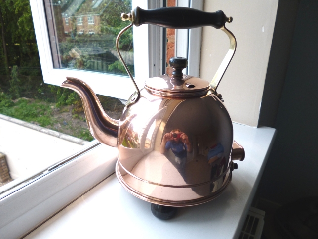

Here is mine from the early 1930s. It is also lower powered, rated at 4.9Amps 200-210V Been using it several times a day for the last 5 years, boiling time isn't that slow.View attachment 63432
That is absolutely beautiful! (I live in an old house and love old electrical kit - esp Belling heaters and bakelite phones) Do you really use it? I wonder if it would be possible to replace a blown element?
I doubt many modern kettles will last nine years, let alone ninety!
Yes it gets used multiple times a day, that's why it looks so tarnished now! If the element fails it can be easily repaired. I think it is simply a length of resistance wire wrapped around a rectangle of mica then insulated with mica either side, a cushioning pad of asbestos protects the element from the metal plate that clamps it to the underside of the kettle. Most of the workings inside is the boil dry shut off mechanism. I'm glad it is there as it's not an automatic kettle and I've accidentally let it boil dry more than once...
It started leaking recently so I intend to repair that at the weekend. The kettle is fitted with an etched brass plate saying it is property of the Woking Electric Co. I hope they don't want it back.
