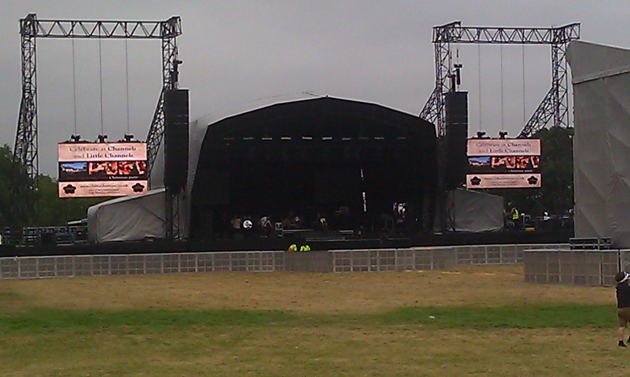

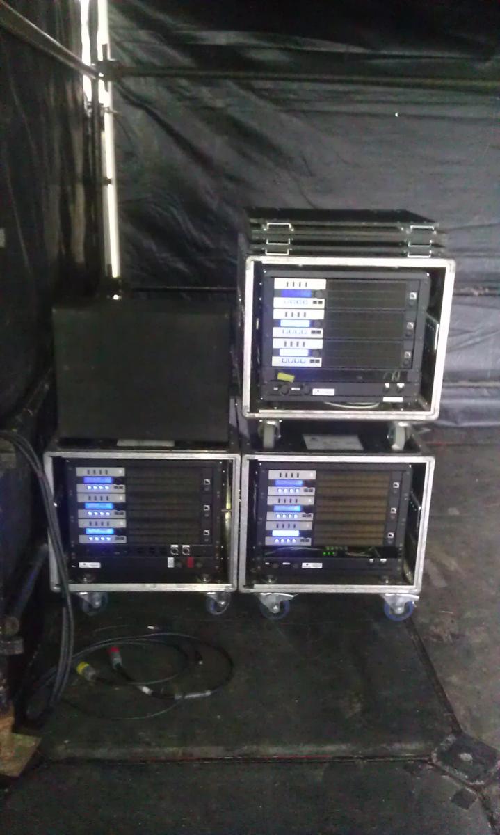

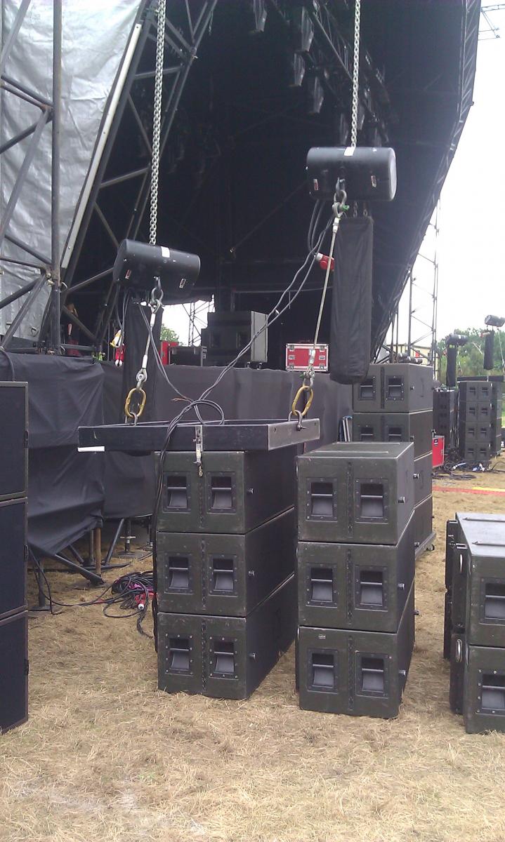

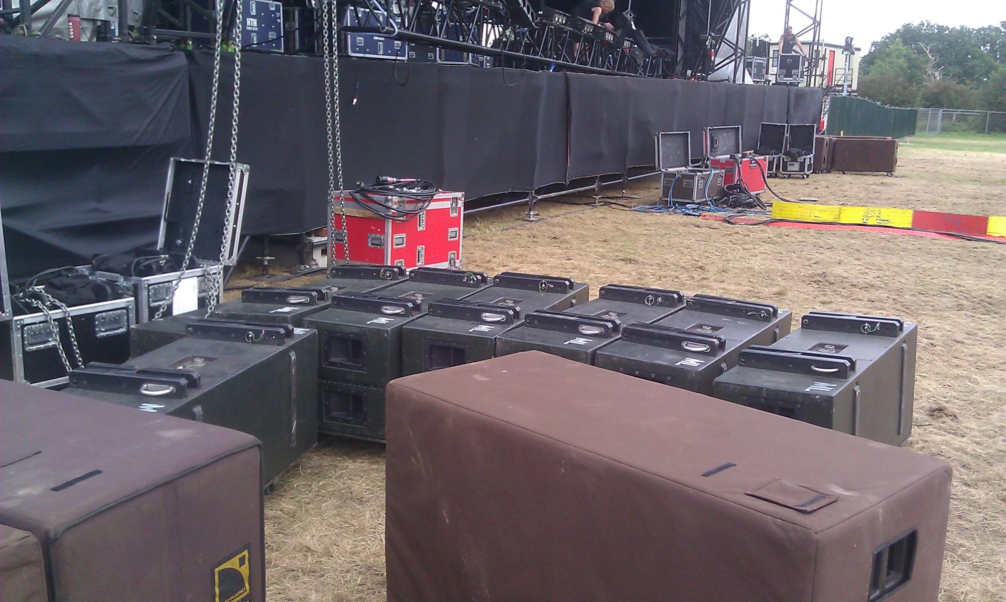

bigger cables are required for big PA in venues, when there may be 10kW or more load.

Does he want me to wire up some of these for him?
IMAG0609.jpg IMAG0604.jpgIMAG0603.jpgIMAG0605.jpg as they can take a bit of 3ph if you really want.
