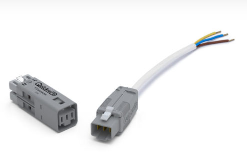

In my opinion the absolute easiest way is to spend a bit on QuikWire prewired plug and sockets. While it would add £30 to costs it makes the job such a doddle with minimal time in the loft, almost all of the wiring done before you go up there.
