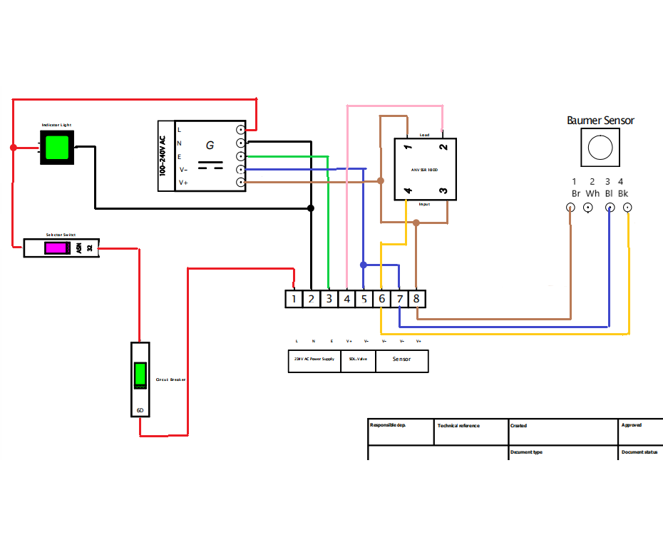

I can see a few problems there...
(EDITED)
1) The wiring to the sensor and relay is muddled up, you have the load side of the relay going back to the sensor instead of out to the valve (which I assume is connected to the terminal block externally.)
2) Which of the two SSR types shown are you using? The S102S11 has a triac output for AC loads only and cannot switch DC (it will stick on permanently). FWIW it also needs an external input current setting resistor. The SSR 10DD is DC output although there seem to be a variety of different versions of it.
3) Does the relay need a snubber / catch diode for the solenoid coil, or is that internally suppressed? Do you need a shunt resistor across the relay input to allow for sensor output leakage (what it its off-state current threshold?)

1) Yes there is a solenoid valve. Muddled up? Can u explain a more on that?
2) Sorry for the confusion. Im using the SSR 10DD
3) Internally suppressed. Doesnt need resistor.
Confuse of the wiring because its based on the previous drawing. i just modify it by using sensor.

You do need some new specs MW. The sensor is shown as having two 'out -' terminals, one of which is connected to the input of the relay and one to the output, while its +ve supply is shown coming from the -ve of the PSU via the solenoid. It's all jumbled. OP, please post the spec / link for the sensor so we know how that is actually connected inside.

Im using the
1)SSR 10DD for the relay
2)Baumer Diffuse Sensor with background suppression O300.GR . 4 wire
(https://www.baumer.com/ch/en/produc...1T_72CU_0000_web_EN.pdf?mediaPK=8800337133598)
3)100-240V AC, 8 terminal strip and solenoid valve.

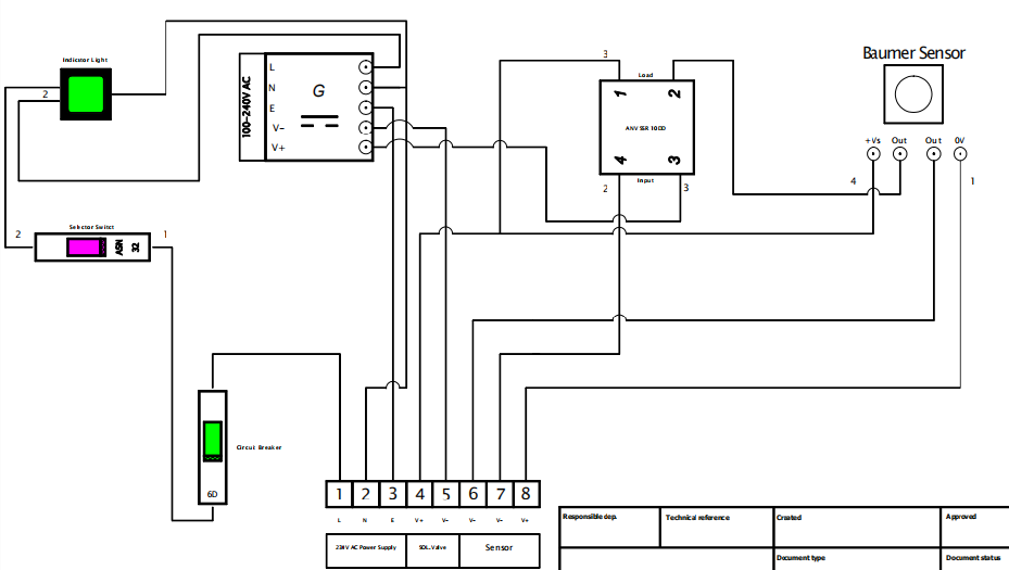

Im sorry its so small. Here the new drawing and wiring. If u you can verify it would be really helpful to meNeed Advise!! Help me with this wiring. NPN sensor/Solid State Relay Capture.PNG - EletriciansForums.net

Here the new wiring that i modify based on what u said on the previous replyNeed Advise!! Help me with this wiring. NPN sensor/Solid State Relay Capture.PNG - EletriciansForums.net

for the additional information. the sensor is push pull sensor.
the system use ssr 10dd, solenoid valve and baumer sensor push pull.

You are in electronics I’m in electrical I know hoe to wire a solenoid you have a solid state relay which needs power to energize then are your contacts N./O or N/C. I guess I need you to paint me a picture of how your devices work and 1 wire had 2 separate numbers on it
sorry sir. the contact is N/O. the sensor is use to detect with background suppresion. when it detect the solenoid valve open and push the air out. i hope it can clarify the imformation that u needed

Is that terminal block inside the valve ?

all the valves I’ve worked on is air to open and spring to close

I'm just worried thenewguy is going to blast 240V through that sensor and kill it
Electro he couldn’t have put 240vac across the solid state relay, it was own a DC power supply
electro he couldn’t put 240vac across the sensor since it is being fed by a 24DC power supply thanks for your help and at least I could read your drawing good job
