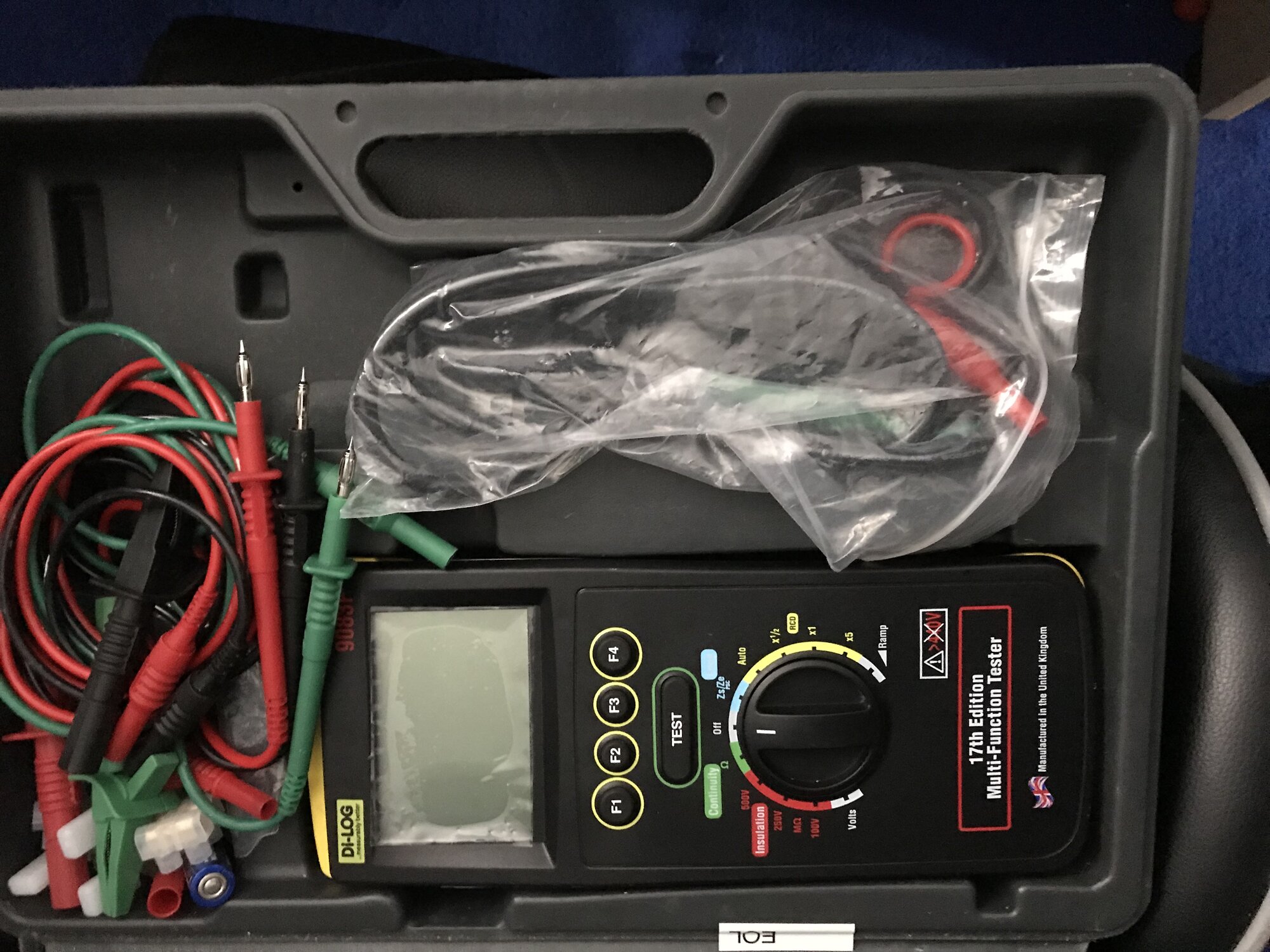

Last calibrated January 21, might be up for selling at a good price, it’s in really good Nick even has the protective sticker on the screen stil, I’m a bit ocd with my tester

I had one of those Dilog units as a spare once, it was a decent unit for the price but mine had issues that were uneconomical to repair in the end.
