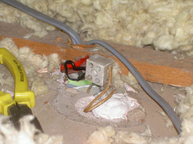

Hi all. I'm new to electrics so am really tearing my hair out trying to find a fault and I'm hoping that with all the knowledge and experience on here a solution can be found. Here goes:
I have two lights in seperate rooms that will not work. I have so far changed the bulbs, changed the fuses and checked with a mains voltage tester to see that power is going to the switches and the bulb socket, it is. Now if power is going to the switch and the light fitting it can only be the bulb, right? Well as you see I have already checked and changed them. Everything else in the house is fine including the sockets in those rooms.

Hi all, No I'm not dead yet!!!! I have just yesterday and today had a chance to work my way round the system and look at all wires and fittings I can think of and taking into account all the good advice you have provided me.
First Q, the bathroom light which I think is the one before the problem has 1 loose black wire in the rose. It doesn't look like it has come out of anywhere but surely there should be none? I can get to it in the loft but as to which terminal it is likely to connect to I will just have to work that out. Another point is the bathroom light works fine but can I assume the lose wire will cause a problem in preventing the power to flow to the others?

I have attached a picture of what I found in the loft. Looks nothing like I expected and it's not too detailed. It had one black wire in a terminal, two red in together in a terminal and two 'gold'(?) in a terminal each. I connected the loose black wire to the terminal where the single black wire was, nothing.
From what's been said before I'm not altogether sure it goes black with black so will have another scan of the DIY book.
Bob

Oh and one more thing. Might be obvious to most but the bathroom light now does not work because of the newly connected black wire so I assume it either does not need connecting (although it was uncovered) or needs connecting to another terminal with another wire.
Bob
Ah ok what you need to do is take the light fitting down pull the three wires through the ceiling and put a junction box on it then use a three core flex to the light fitting , wiring you have there is a standard in out switch ,so you first have to identify the switch wire , and lable it up ,you have two neutrals ,4 lives one of them will be black ,the return from the switch ,connect the three reds to gether in the junction box , then connect the two blacks and the blue from the flex together in a junction box , then sleeve and connect the earth together in the junction box then you should have 1 black left this is the return from the switch connect that to the brown of the flex ,push those heat resistan wires back into the light fitting and connect them to the three core flex one to brown and one to blue and the earth to the fitting case .hope that helps
Hi Nick. Thanks for the advice. I have taken another pic of the mess (side on). It shows the red wires not connected to anything. The loose black wire, the two blacks connected to seperate terminals and the two gold wires connected to two seperate terminals.
The two golds then go to the light fitting so I assume they are the switch live wires? The rest is connected as it was but now thanks to my dud finger the bathroom and all the bedroom lights are out.
Please bear in mind apart from knowing to turn the power off I am a complete idiot at trying to work these things out.
Bob
