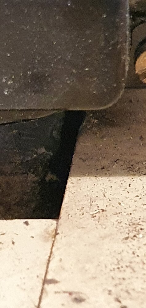

I recently was called out to look at a possible rewiring job, The customer had someone in to do some work in the bathroom (6 months prior) as part of that work they changed to consumer unit and put an Earth stake in.
Anyway the consumer unit was a mess, you could tell the previous electrician didn't quite know how to fit a new mantel unit and as a result he got himself in a bit of bother...
I'm not quite sure of the series of events but I was curious to why the previous electrician had put a rod in, I could see it would have been an TNS supply, I also noticed that I could see evidence of superglue around the rear of the cutout....
Its not obvious but when you look carefully at the picture you can see the whole cutout has dropped and its not fixed.
It was then I noticed scorch marks on the bottom of the mantel unit...
I believe the previous electrician pulled the fuse and shorted the incomer to the mantel unit, possibly losing the suppliers earth at the same time...
Fortunately I noticed this as if I had just gone in and pulled the main fuse I would have been in serious trouble, but this has definitely changed my view on pulling main fuses.
Yes, a lucky escape there. As you say, something to be very cautious about doing.
