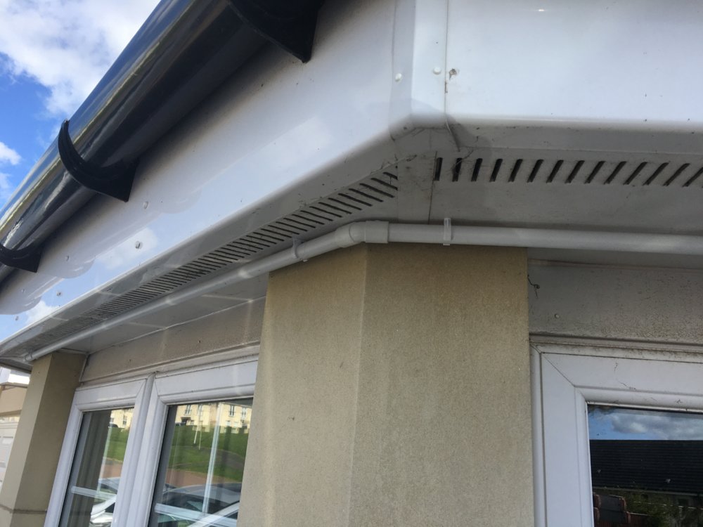

Cheap LED sticky tape stuck to the underside of my pipe from #54.... bathe the front of the house in blue for Thursdays clapping for nhs
It’s 3 colour, RBG.... can fade or jump between the colours, or change in time to music.... but the mic and controller are inside. I’d need a speaker inside and out to get the effect

They won’t last long... not entirely IP rated for a start.
