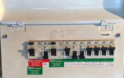

I have a quick question. My garden supply CU has a 100A AC RCD as main switch - off that is my greenhouse supply circuit. Then a 63A AC RCD which protects 7 circuits, one of which is a pool heater. I am replacing the old heater and the new one requires residual DC protection. Can I replace the 63A RCD with a Type A ? My gut feel is that I will have to replace the 100A RCD main switch to a Type A as well ??
Could another option be to move the pool heater circuit next to the main RCD switch , then it's own supply to a small sub board with a Type A 30mA RCD protecting the circuit mcb ?
Can we have a photo. From your description is seems the circiut in question is protected by 2 RCD’s in series. I suspect this isn’t the case, but best make sure with photo.
Sorry I should have worded that slightly better. Main switch is 100Amp 100mA AC RCD. The greenhouse supply is installed but not live yet ( being rejected next week! ). The RCD protecting other circuits is 63Amp 30mA Type AC. Just trying to get photo for you.
thanks. Sounds better. I’d assume a time delayed 100ma. Also I assume you have an earth rod (TT system) for your earth path.

Thanks for replying. My situation is a little convoluted at my property, I installed an earth rod making the garden supply a TT as it shared the PME earthing arrangement with the house supply ! I have two 100Amp supplies coming into the property ( one for the house which is TNCS and the other (supplies garden on it's own) had no direct earthing but connected to MET where the PME arrangement was shared !) I disconnected the old earth conductor from that MET which went to the old CU in garden !

It shared the PME via the earth conductor connected to the MET in the meter cupboard ! I made it a TT by installing a new earth conductor to an earth rod and disconnecting the old conductor .
Right, I'm lost! Are you saying that CU has two independant supplies coming into it; one connected to each of the RCDs?
Surely if a DC sensitive RCD is downstream of a conventional one, in the event of a DC fault, which will 'blind' the conventional one, the DC sensitive RCD will trip, removing the DC component, and the upstream RCD will then be 'unblinded'.
The way I read the opening post and additional replies.
2 100A supplies
one for house cu
one for garden CU.
the garden CU has been turned into a TT.
main switch in garden CU is a100mA RCD.
the heater circuit in garden CU is protected by a 30mA RCD As well.
as for the blinding. Could the heater being installed blind the upfront RCD from conventional faults on other circuits During normal running of appliance without a fault on the heater.
hope that made sense.
2 100A supplies
one for house cu
one for garden CU.
you got it Pete . two supplies . one does house , other for the garden which is about 15 meters away.
new supply was added when house extended and work done in garden, one supply couldn't handle the total demand. Both supplies shared the same PME earthing arrangement.
