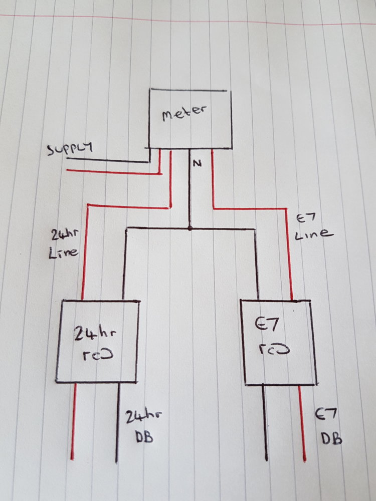

a month ago She Who Must Be Obeyed, decreed that we should have an ESH in the living room and another in the dining room (we won't go into the why's and wherefores right now, i'm just the labourer round here )
so.... ordered 2 nice dual input ESH's (Newlec, but Dimplex by another name), and duly fitted them....
i noted that they required a second (peak) supply into a fused DP point, so put them in as well.
connected the whole shebang up, all seemed great, until the next morning when i noted the rcd had tripped overnight., as E7 was still live, i isolated both ESH's and reset the trip, fine , stayed set ok.
switch on either ESH and the rcd trips.
well, seems i've cocked something up, so, check and recheck all ESH connections... all done by the book, and no obvious errors.
next i make up a cable to connect NSH direct to 24hr supply ..... works fine, no tripping, left for 2 hours for heater to warm up... all ok.
ok, the E7 DB is forty years old and running on 20a cartridge fuses and 60a mcb, (none of which are tripping by the way), so i fit a nice new DB with 100a mcb and 6 20a mcb's ... it would have had to be changed sooner or later anyway.
and we still have the rcd tripping! ....
nothing else, just the main rcd, and if the mcb's for each ESH are isolated then all is ok... and that is just removing live from the circuit, so what can be causing the problem? .... the only thing that has changed from when the old ESH's were removed to when the new ones were installed is the METER ...
going to need some help here guys....

having looked at Marconi s wiring diagram above.
long shot.
could you have wired the 2 standard and night supply neutrals together instead of in there individual terminals.
this would explain your system working when transferred into the standard 24 hour board.
if you had done the above then the return night current would have an alternative path through the daytime neutrals Cu. Thus the imbalance tripping the RCD On the main Day CU.
Is the RCD a double pole isolator or single pole isolator. If it’s a single pole I would guess the night storage heater would continue to work and be warm in the morning. Unless the night tarrif CU is protected by another RCD.

Need a wider picture of the full set-up. Something doesn't seem correct, assuming the service terminal block is outgoing from the rcd it has five conductors connected which seems wrong. It appears one conductor bypasses the rcd.
Is the meter above left of the rcd, I suspect the line to your E7 is not rcd protected but the neutral is going through the rcd.
you're quite correct, and this was how it was left after the new meter was fitted.
are you suggesting that i fit a second rcd for the E7 circuit, so that (as far as the E7 circuit is concerned) both live & neutral go via an rcd ?
That is your problem. The line and E7 neutral are creating an imbalance as one uses the rcd while the other does not. If you have a TT system and that is the only rcd then the E7 circuits a not likely to have fault protection. The E7 needs a separate rcd with its neutral taken from before the current rcd.

This is the set up you require.
ok, that makes sense to me... and easily done, apart from taking the neutral prior to the current rcd .... there is no available (extra) connection point, unless i fit a JB into the incoming neutral line ?

You need another single pole service terminal block. At this point you need the services of an electrician as you are touching wiring which strictly speaking can only be isolated by an authorised person.
It's a pity we didn't have that pic to start with. The OP did stress that the only thing that had been changed recently was the meter, but I suppose we all overlooked something so blatant as the tails being connected up wrongly, which could never have worked.
The E7 line which bypasses the rcd does seem an alteration, black cable tie fitted. I suspect this has nothing to do with the meter change. I suspect when the rcd was fitted to replace the voltage operated device some time back the E7 was no longer in use so no problem was evident.

It's naughty, whichever way it came about. With any load on the E7 board, in the event of a trip the house blacks out, but every single point is still live, both on the E7 and the 24h and there is more risk of shock with the RCD off than on. It's a good thing it was self-incriminating.
it's a good point.... but, as it stands, with the rcd tripped, the only live would be to the E7 cct, both live & neutral to the 24h cct would be isolated.

No they wouldn't, if there's load on the E7 DB, that's why it's so dodgy. There's a path from E7 line, through the E7 load to the E7 neutral bar (which is now at 230V w.r.t earth), via the splitter block to the 24h neutral bar also now at 230V, through the 24h load to the 24h line. There's no circuit to supply neutral so none of the loads work and it all looks dead as a dodo, but every conductor in the installation is sitting at 230V via the loads. The resistance of a heater in series makes no practical difference to the severity of an electric shock. And there's no RCD protection.
yes, unless all the mcb in the E7 CU are off

neutral split via new JB, new rcd fitted (80a) new tails where needed.
ccts are independant of each other now, each with own rcd.
what can possibly go wrong ? :)

ok.... system working fine (well, apart from the fact that i failed to switch on one of the heaters ... doh) .... i checked them at 4 this morning (and switched on the one i left off last night !).
So, big thanks to you guys... saved me a lot of time and money, although i will still get it all checked by Mr Sparks on monday.
on reflection.... i'm a bit ----ed off with whoever fitted the new meter, and left the system in a dangerous state, i'm just lucky that i had no loads on the E7 side and the mcb was off. AND it cost me £100 plus to remedy, on the plus side thankfully no-one got hurt....
