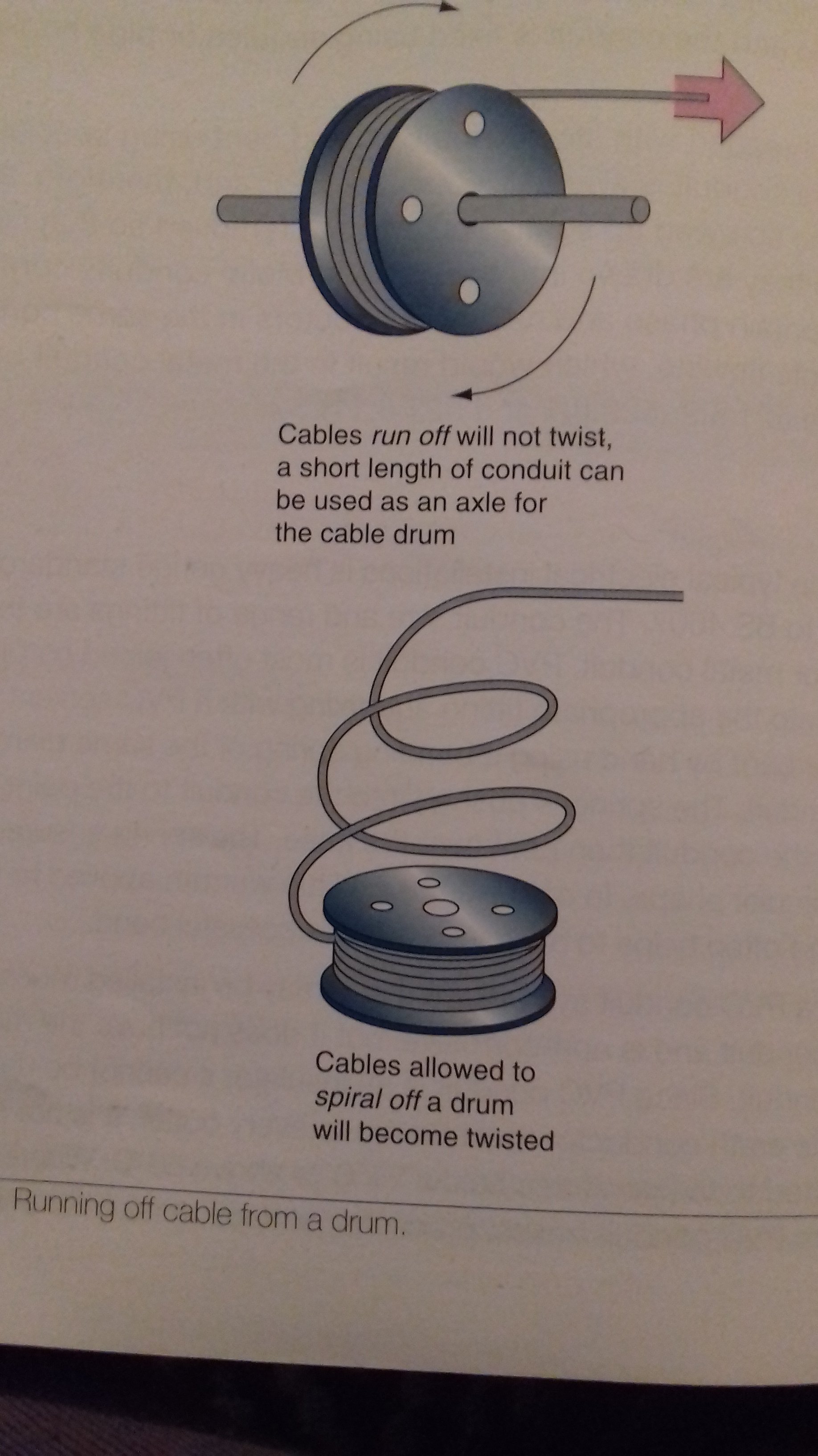

It wasn't the OSG or bs7671 where I saw something written about it, it was the BASIC electrical installation work book I got in college hahaa.

There won't be a problem with eddy currents, twists just make the cable snag as it's pulled which can cause it to become damaged. CAT5 (screened preferrably) makes far superior speaker wire than flat twin electrical cable. Much better frequency response and a hell of a lot cheaper as well

Leave the roll flat on the floor and pull the cable hard so the roll spins around and the cable un-furls, the worst is when it gets wet and the card board rings fall off as then that is where all the wrist action learnt as a 16 year old comes in handy un-rolling the cable reel.

I was taught to : lay the drum on it's side take the cable off the drum using both hands, take as much as you think is required, and then run it out on the floor, very difficult to explain, with out pictures, don't ask me to draw it out either.

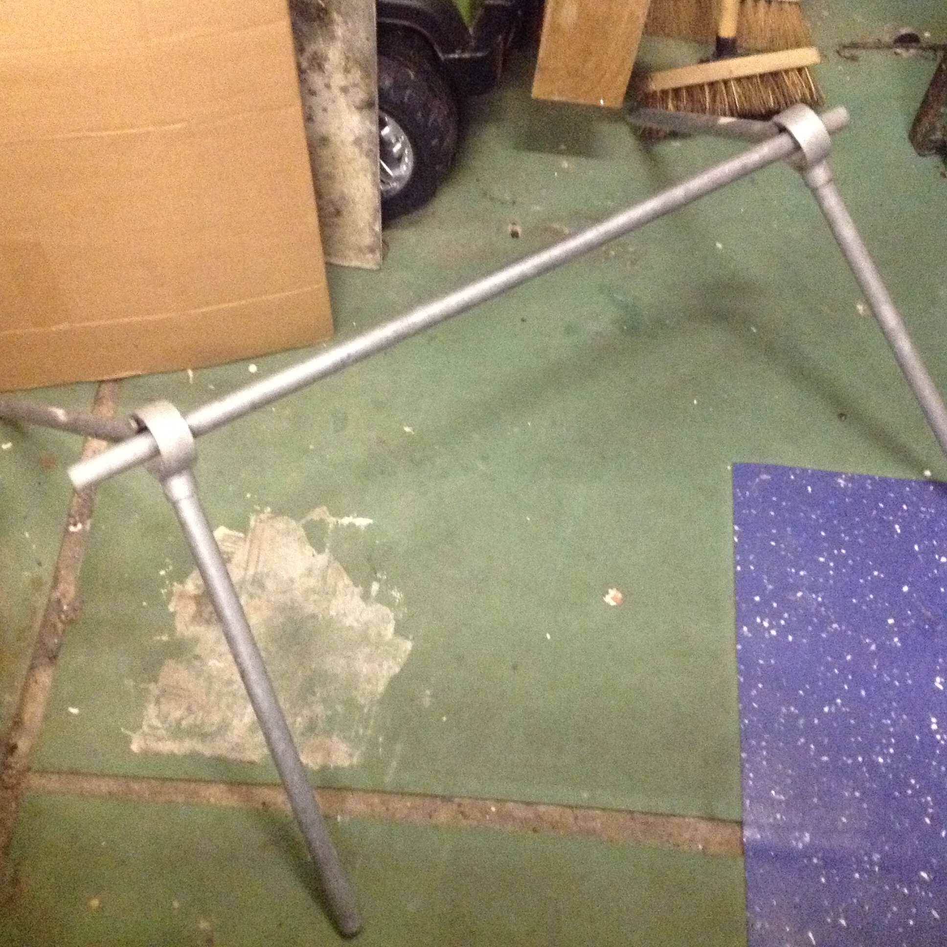

Is exactly what I was thinking, and what I did before I bought one of those pesky A frame spoolers most merchants seem to have. Not that they're ideal in every situation. Sometimes the kick method works perfectly adequately.
That said, a cable mate and a scaffold pole works wonders too.
