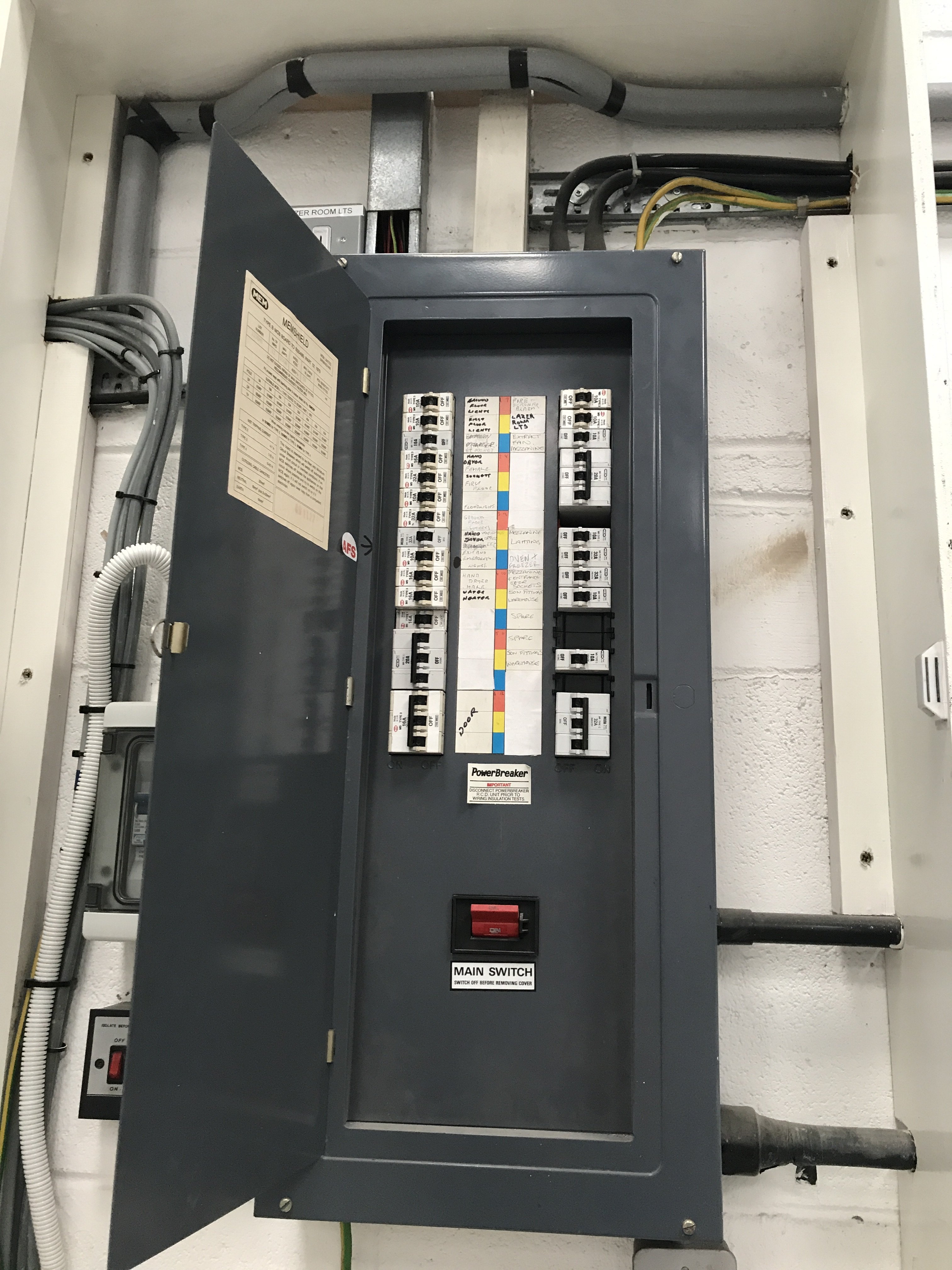

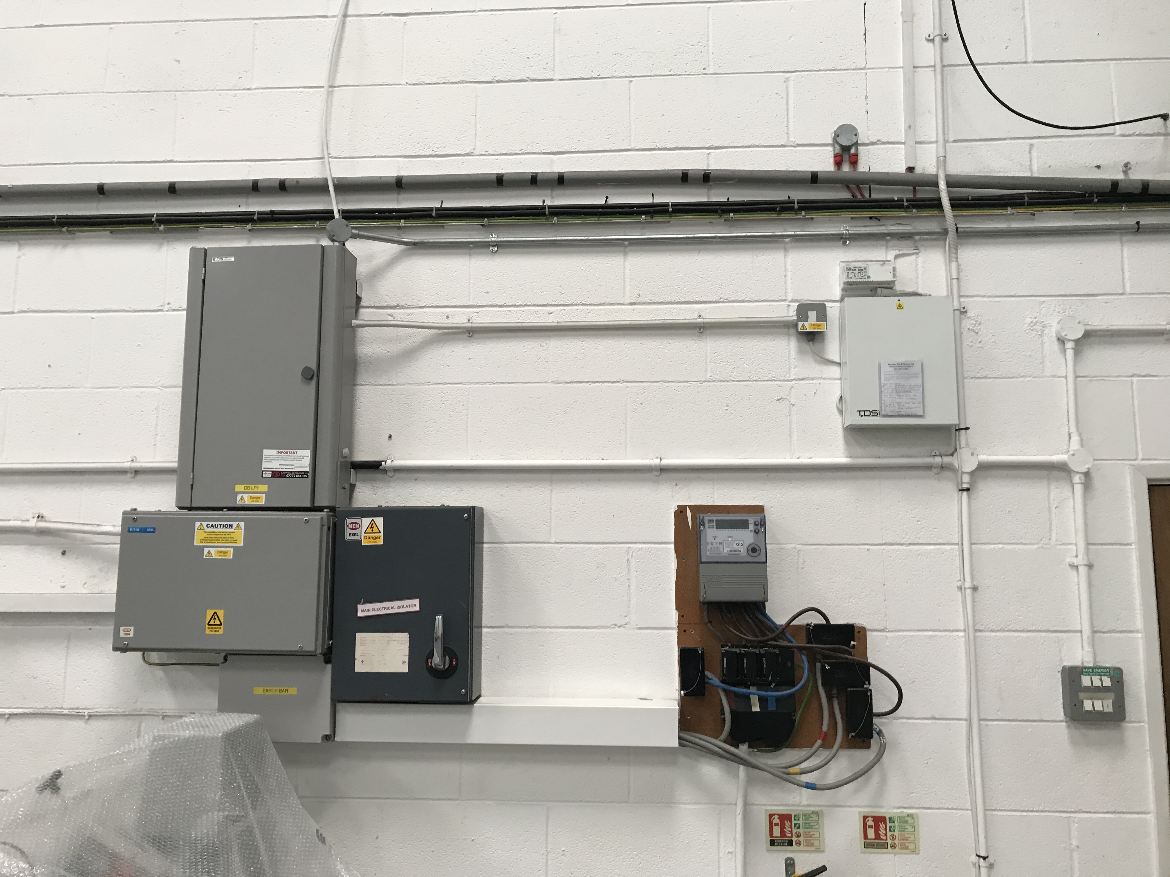

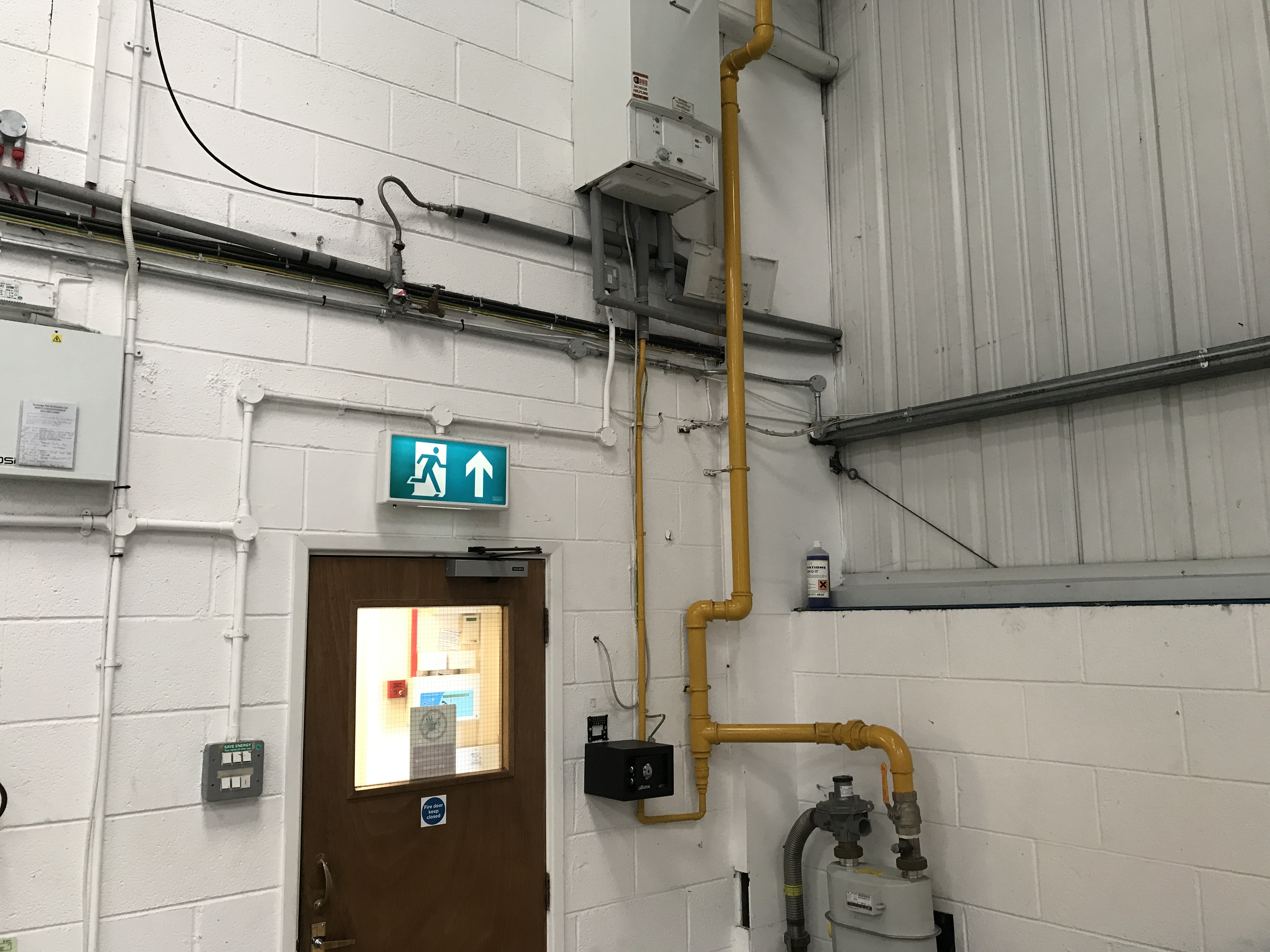

I haven't got that far yet to be honest. I've just had a look at the job. WPD are proposing to install a 200A CT panel but it's on a wall 90 degrees to the existing. I was thinking SWA but I was wondering about the bending radius on the internal bend as the cable I'd imagine is going to be 70mm and how I would get around this internal 90
Yes these are the existing installation pics. The existing incomer is to the left of the brown door. The proposed new incomer is to be installed about 10m across to the right of the brown door on the wall 90 degrees. Where the green fuel tank is currently.

A pair of bends on each wall can kill bending problems,you could mount it on a tray with a step up or down in the corner
Mark, you still haven't confirmed that the existing will be removed, sorry to keep on Mate, I guess the question should be will you be doing a complete rehash of the distribution switch gear?
What would you fix the tray to? I'm not sure the metal panelling would be very strong for fixing to and the block work would be to low and liable to damage with forklifts around
The brickwork looks favorite to me, hasn't bothered the gas meter people has it? You could always use Metal Trunking as a way of getting from A to B
That's true, although there is racking along the block work and there's a good chance of the cable being crushed by forklifts loading and unloading the racking
Wouldn't be much of a fork lift driver if he hit the racking and the cable, have to be going some to crush a 70mm2 SWA
