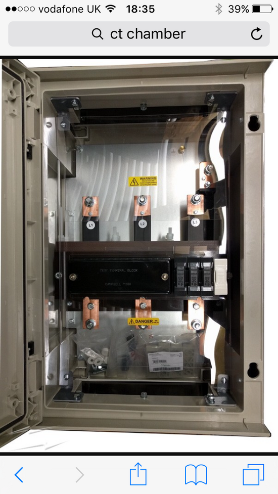

Ok. Thanks for all your advice. It's very much appreciated. I've just been reading through the WPD paperwork and it specifies that "The tails should be Tri-rated cable" Does anyone know if SWA is classed as Tri-rated?

This is what the paperwork says
Ask them for clarification Mark, I've done plenty of these and have never used tri-rated, in fact EDF specifically say not to use tri-rated for the meter because of problems with tightening up the terminal on the tri-rated cables.
Surely the cables will be in crimp lugs to attach to the bolt terminals in the cutout? Much easier to feed through the CTs than standard tails.
You don't thread the cables through the CTs anymore.
Never installed tri-rated in a CT chamber normally either a swa or normal singles. Only ever worked in London/Essex though so it might be different elsewhere.
Interesting, the last 4 I did all went to the cutout fuses. I've never seen on like that before. Perhaps not used often in this part of the country.
The one in the photo is a Ryefield and I know the Blakely is the same, I've never seen any other type! Must be regional.
