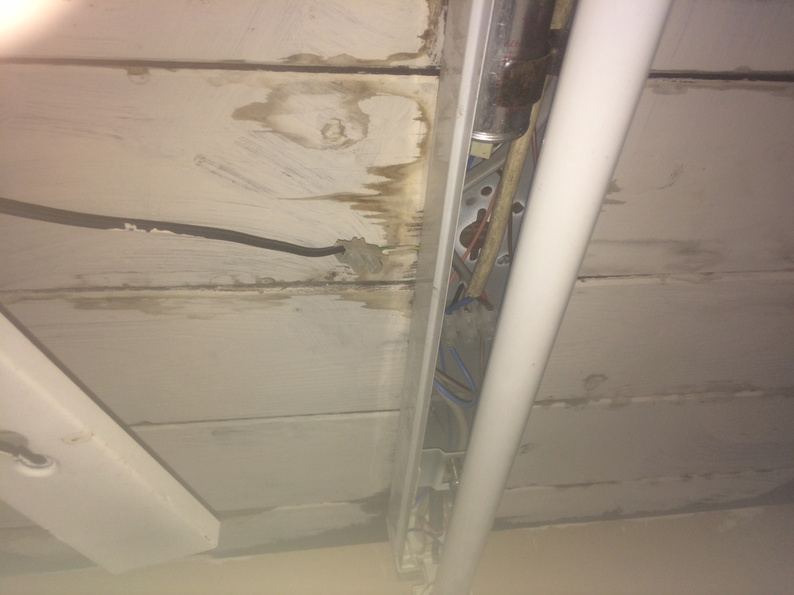

There are other,quicker ways of identifying this particular problem,if you have complete control,of the installation. There is also,the chance that the neutral shared,is not from another lighting circuit,just a nearer,available neutral. I have seen this on occasion,where the reverse of a lighting switch,is adjacent to an airing cupboard.
Too true.
This was in the suspended ceiling of a kiddies toilet in a nursery
