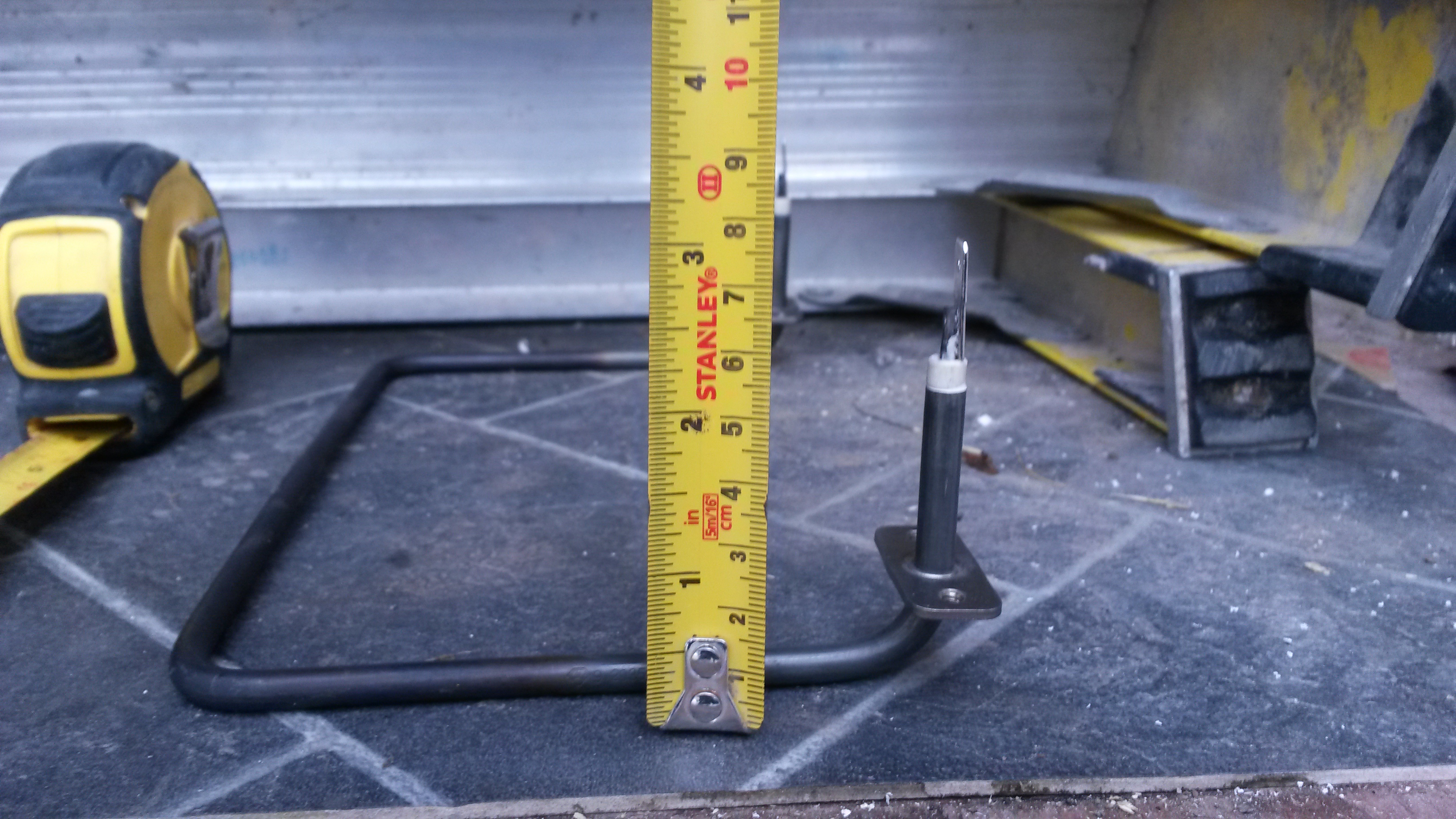

Hi everyone having troble finding a element for microwave oven the appliance has no part or model no. and i have striped it and looked everywhere And tech where not much help without that info here are pics if anyone of you could help thanks again

Yeah client had a "siemens engineer " looking at his appliance a year or so ago and he said it was fault on circuit tripping rcd so i tested circuit kitchen socket ring all fine,rcd xs and ramp test all good
Checked all outlets and appliance all good check cable run all good i could see in loft then looked i looked at microwave and within 5 mins found it was element at fault
The element looks rather unused. Have you tried running it somewhere outside the microwave for a while to drive out any moisture?
Yeah element has a small crack on it and when gets warm it shorts out i have worked with a alot of elements from domestic to industrial and are familiar with test procedures my old man mentioned that you cam get elements made to order if anyone had any contact information

Oh sorry missed link mate dam phone is to small or eyesight getting worse i will send them an message thanks in advance
