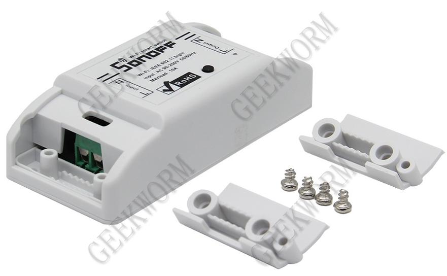

I bought a Sonoff wifi switch for about £8 from Amazon; I've fitted it to a modern table lamp, and it works very well. I'm thinking of buying some more, but I have several lamps which are made from old ceramic vases with a brass bayonet bulb holder at the top, all of which have 3 core cables to their plugs.
The Sonoff switch only has L and N connectors, no earth connector, and I can't see a neat way of connecting the earth from the lamp to the plug without using terminal blocks inside their own protective box or some other such Heath-Robinson setup.

Hi Westward, this is a pic I've just found (not my own pic as I'm at work at the moment). You can just see the two small terminals for the live and neutral, and there is an identical pair of terminals on the other side of the unit for the output. No provision for an earth cable, so I'd have to run that outside of the unit in as neat a way as I can muster...
Yes that doesn't provide a facility to connect the earth and running around the outside of it isn't the best solution. The only option I see is to replace the brass lampholder with an all insulated one (plastic) and rewire using two core cable. I suspect your lamps have a metal tube to which the existing lamp holder fits to which wouldn't need an earth providing as long as none of the conductor insulation (the brown and blue wires) is exposed to this tube and they are contained within the lamp holder.
Ah, that sounds like a much better idea than mine, thanks Westward10 -- a bit more effort but then at least I know it's a 'proper' job rather than a bit of a bodge. Thanks for the suggestion, greatly appreciated :)
